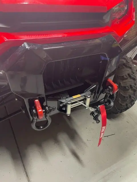

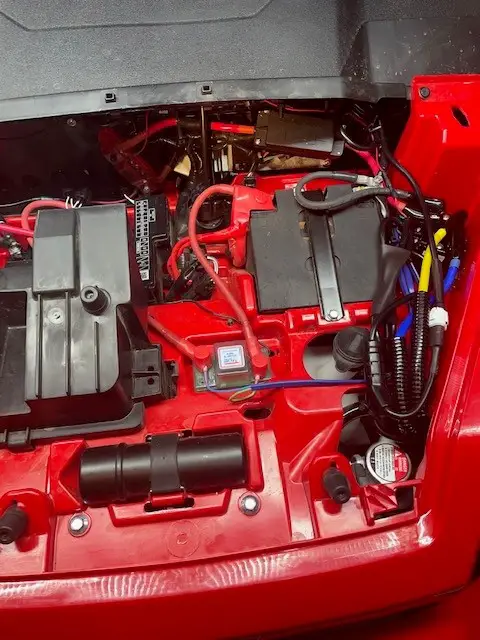

I started in on some enhancement. Dual battery, isolator, stinger relay, HF winch, KFI winch mount, dual volt meter. I opted to not do a fuse block like so many. I knew I was going to use relays for lights and other electrical add-ons, so I just bought relays that have fuses in them. I bent a piece of kydex and made somewhat of a firewall to screw relays and inline fuses to. You can see it on the passenger side beyond the dual battery location...a few holes in the bottom and ready for more relays. I wired the red bus bar to the stinger relay, stinger relay is triggered by the ignition factory pre-wire on the drivers side. Stinger relay on passenger side along with a negative bus bar. Positive bus bar on my make-shift firewall. Winch wiring all on the drivers side. I'm trying to decide on lights. I like the idea of a couple 6" round KC style lights in the center, top of the bumper. I'd use riv-nuts to attach. I've had light bars up high on the a-pillars; they become tree hooks at my ranch, just trying to think of an alternative to the light bar. I could put a 10-12" light bar above the winch, bolted to the bottom of that center bumper area...open to ideas. Oh, also added shackle brackets and shackles.
View attachment 363339View attachment 363340View attachment 363341
Looks good.
I'm not too familiar with the new bumpers/dimension but if it doesn't block too much air flow, looks like you could probably put a 10" bar over the wench (bottom of upper bumper section) and a 20" on top of the bumper 🤷‍♂️
I have a similar set up and it's pretty bright for being the slim bars.
