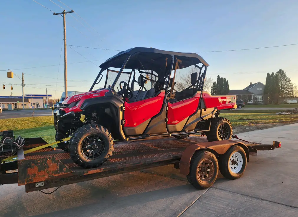

Trying to talk my neighbor into one instead of a Polaris Ranger XP.

Lucky he didn't lose that one with 0 miles on it by the looks of the trailer and the way he's got it tied down?
He's likely hauled 700-800 cars all over the midwest on that trailer since I've known him. Never lost one that I'm aware of.
But ... not my circus, not my monkeys! 😄
