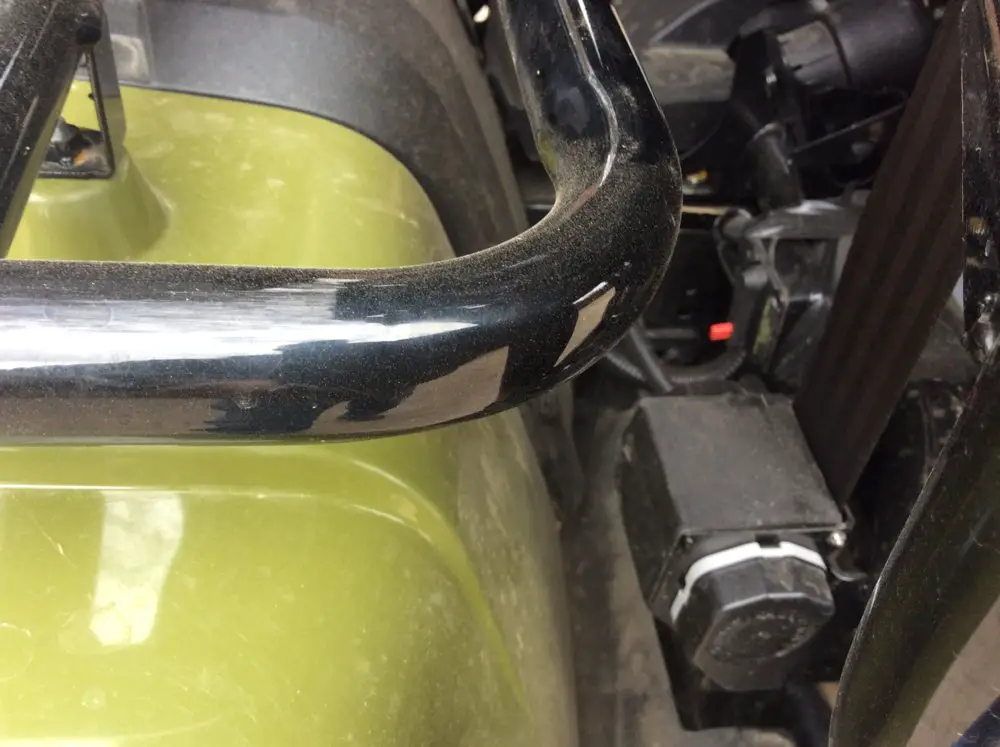

Ran a 6 ga wire to the hood out of the battery cover box square hole behind the positive battery terminal and mounted a Bussman waterproof switchable breaker to the large diameter frame tube behind passenger. Out of the way but easy to get to. See red button in pic. Wire in split protector. Normally kept off.
IMG 3362
Reactions: trigger and solrus
That's a good enough spot for it!!
