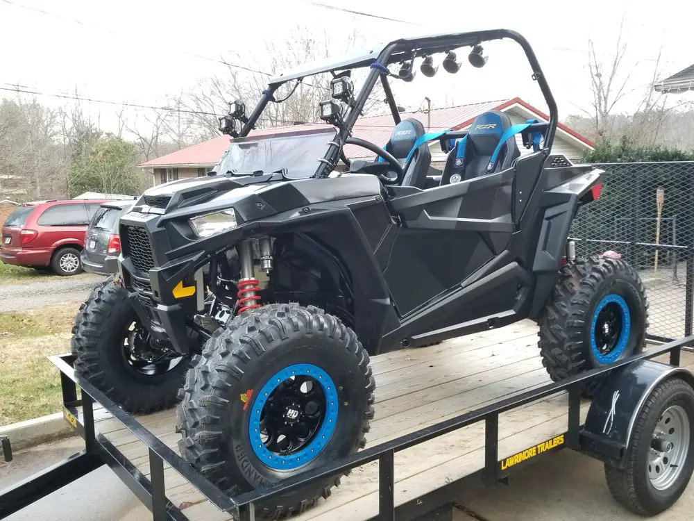

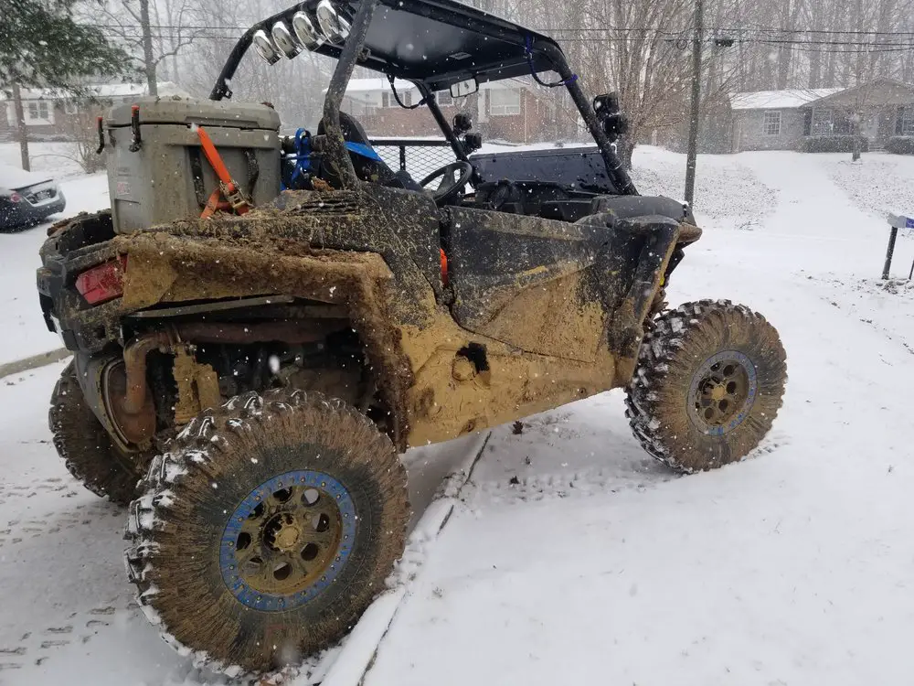

Delton I got a few upgrades since bull run
20171207 072310 20180116 095735

did you go any wider with your offset wheels or add any spacers?
Yeah wheels offers 1 inch wider to the ouside than stock..front tires 1 inch wider than stock..rear 1 inch narrower..32x10x14 GBC dirt commanders on 14x7" STI HD beadlocks..3 inch Super atv lift kit..2017 1000 S Polaris rzr

I like the looks of that.... sorta what I want Honda to give me. But I like what you have done.....
Thank you..I myself am a Honda guy..but I wasn't going to be working or hunting full time with my buggy so I had to go with what suited my needs best..maybe a different brand when Honda releases a true sport SxS

i knew it looked pretty tall, does it feel tippy at all?

Not nearly as bad as my first ride..first ride my spring and shocks were completely stock and had 10psi in all 4 tires and it was horrible..rode more stiff than I expected and tires wouldn't grip anything..next ride (about a week or so ago) I ran 5 psi in all tires and let off all the preload in front springs and lowered shock compression..rode much much smoother..it dropped ride height about 1.5" even that small amount helped stability a lot and the tires crawled over anything in their path..very very satisfied with it now
