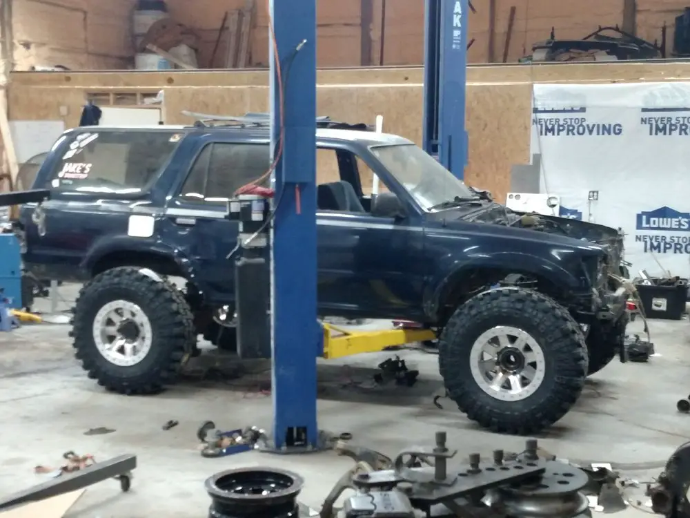

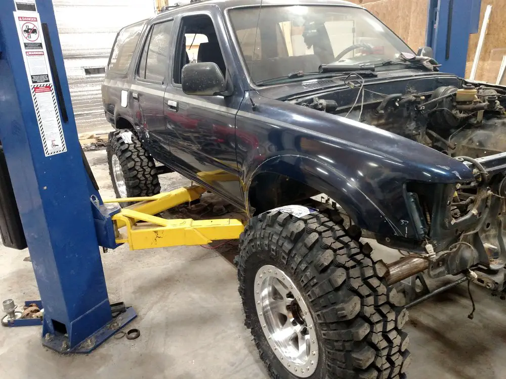

I'm tired lol. Got the axles stripped, shortened 6", all the hubs redrilled to 8 on 6.5" and tires mounted. Pretty sure I'm going to get some 40's instead of the 37's I got. Anyone need some new 37x17 rim tires?
