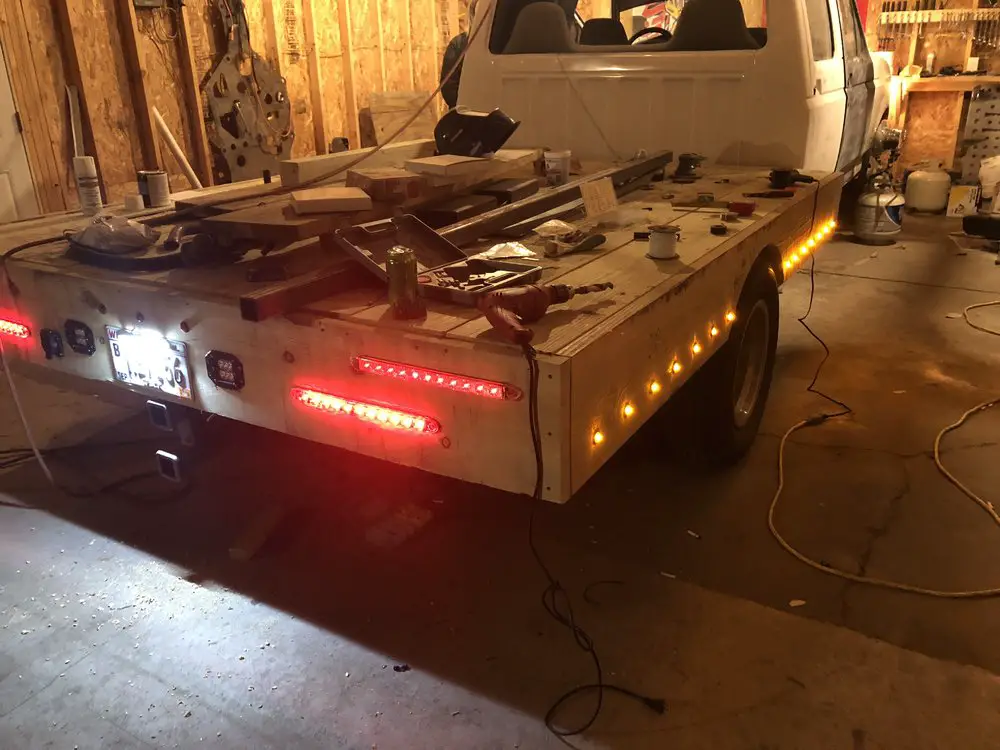

Got a few more lights wired up. So much soldering and soldering and more soldering lol. Only one more side to go.
Looks awesome man I love the lights. Especially the reverse lights.

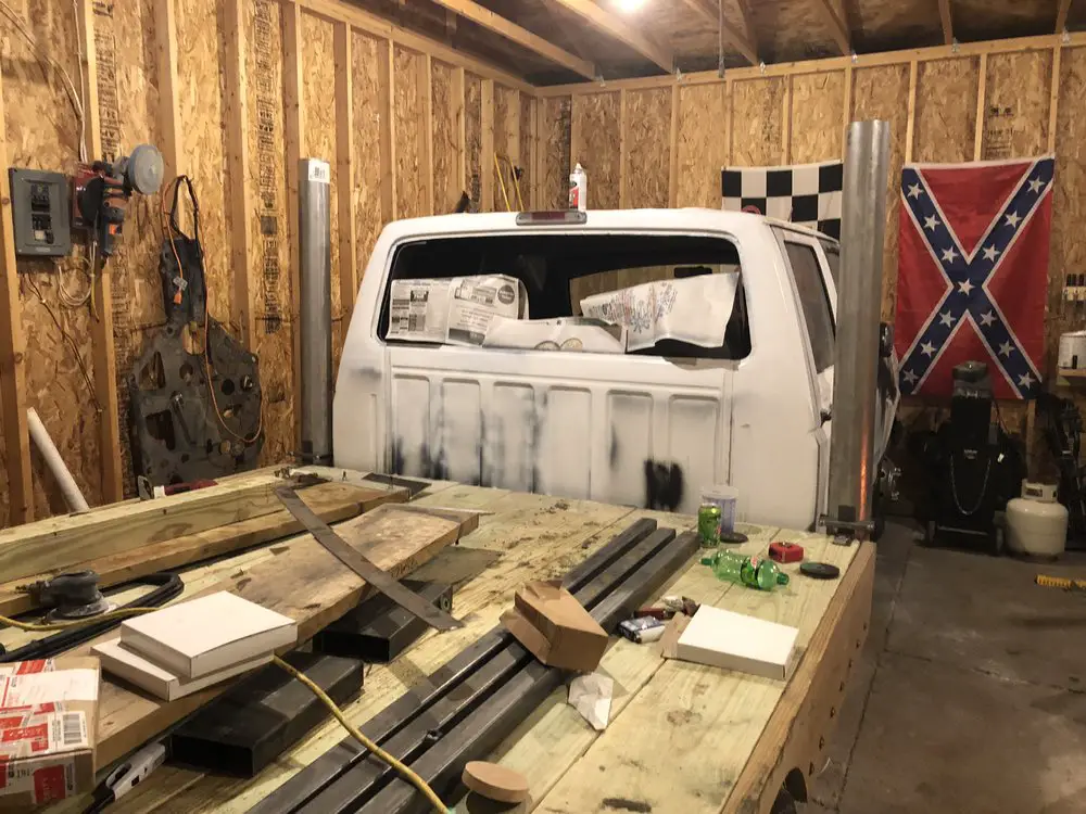

Your flat bed is 9’ right? Is that the bear minimum in length that it would still fit? If 9’ long what did you do after the frame rails to help support the weight of the rear end of the machine. Do you still have a useable hitch to pull a trailer?
Mine is 9’5” long. I used 4x4 cross braces along with 2x12 side rails and 2x10 deck boards. The tires sit directly on the cross rails. I used a 6” extension to still have the hitch sit flush with the back bumper.

So the extension is like a super hitch? Do you think that the extension will need any extra side load support? I think the super hitch’s run chains out to the side of the frame. Was 9’6” the shortest you could go and still get the 1000 to fit? I’ve been kicking around the idea of doing a flatbed too
