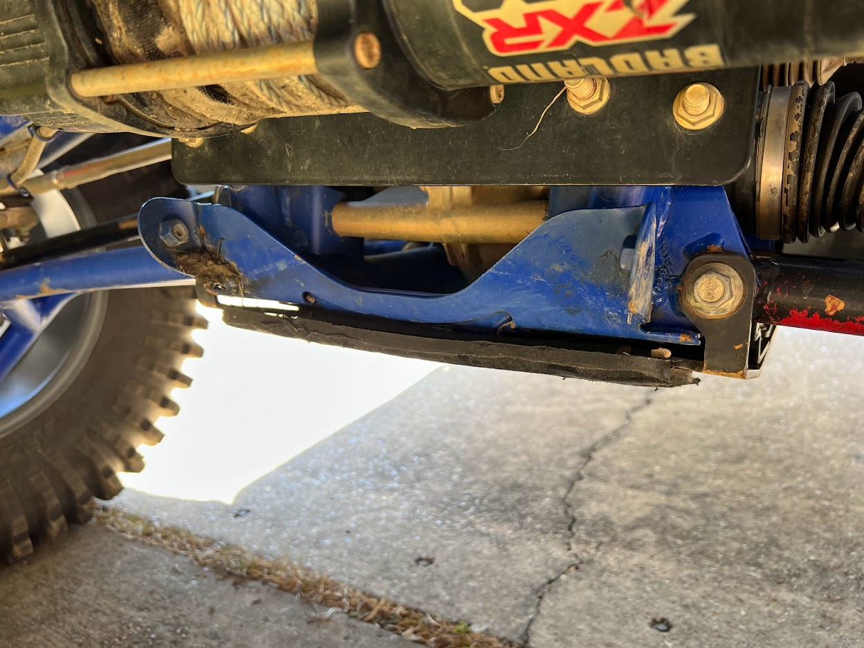

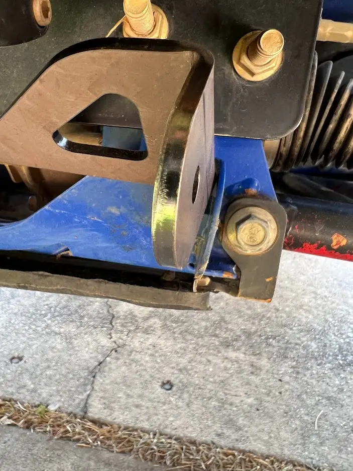

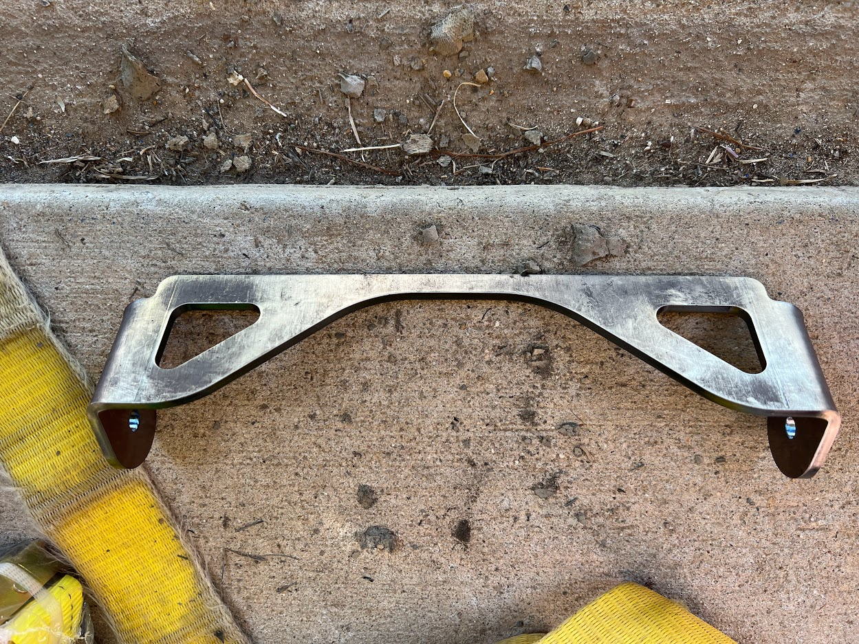

Going to cut off these janky .080 bumper support tabs and weld in the Wherli Fab SXS .180 plate. I picked this up a few months ago and it's been sitting in the box in the garage because I never felt like pulling the bumper off.
Wherli Fab SXS Talon bumper mount plate

Replaces the stock .080 sheet metal tabs here. Cut them off and weld in the new plate:

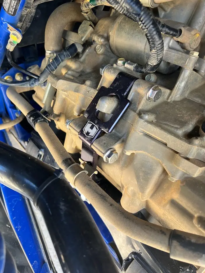

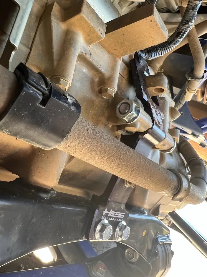

Hess motor mount finally showed up last week so I got that installed as well. Saw where guys were breaking the motor mount on the case so this will add some additional support:
