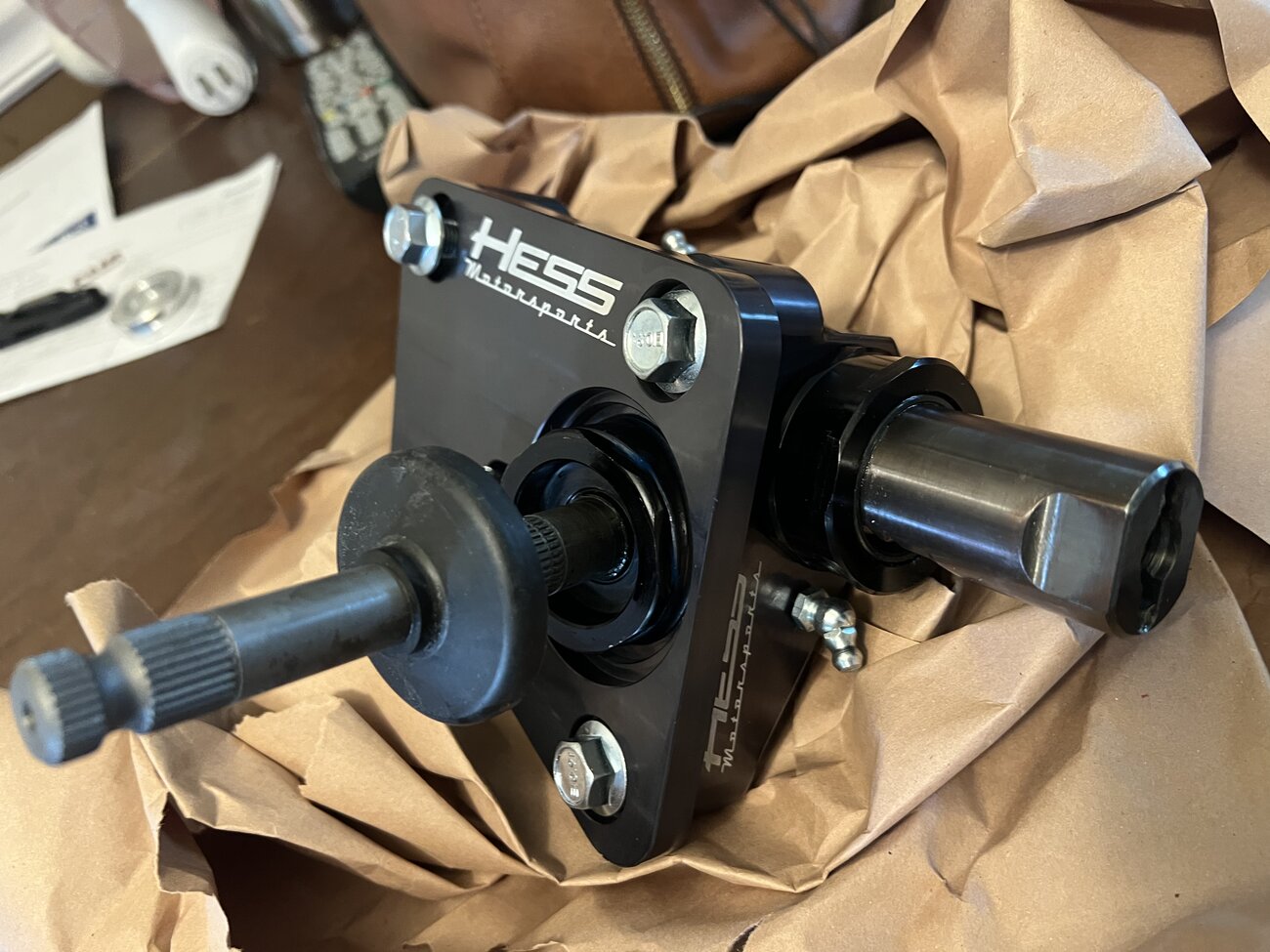

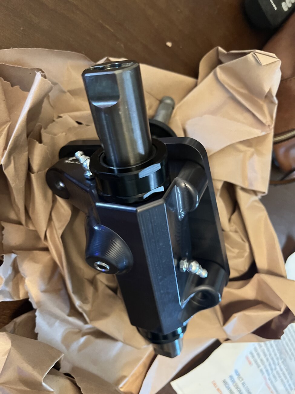

Steering rack has had a tiny bit of slack in it for a while now. After the windrock ride and the power steering addition, it’s got enough to trigger the steering angle sensor fault for the live valve. Ordered a Hess rack and support plate that came in today. This thing is a unit! Not looking forward to the install but shouldn’t have to worry about steering rack issues any longer.
View attachment 377953View attachment 377954
Damn gravel roads are brutal on these POS Hondas......

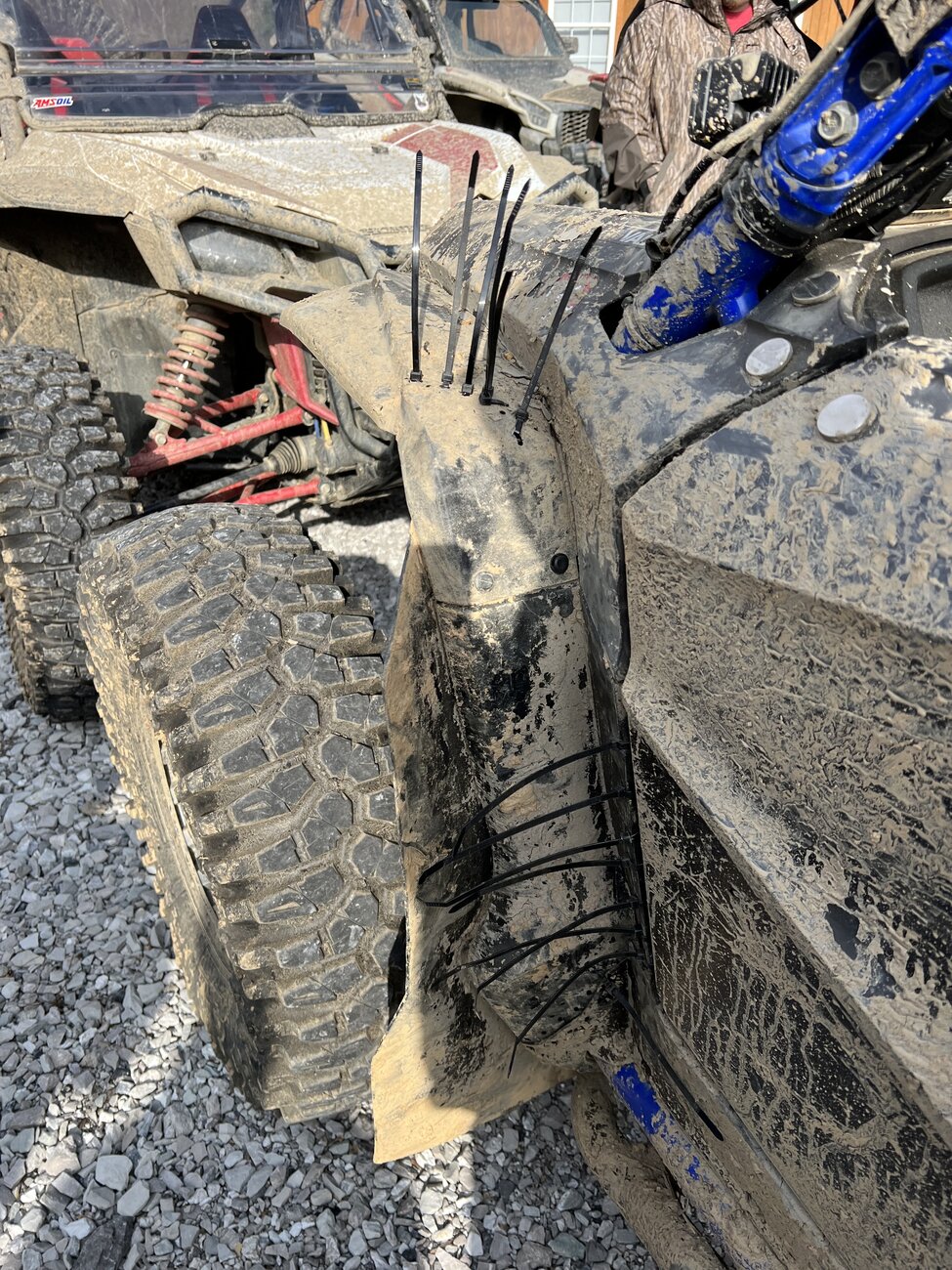

I’ve b****ed about these fender mounts before, and I fixed them on the passenger side a long time ago. Driver side was way worse. This is the dumbest design….
8746DB8B 1C5F 42CC A50E F92E9AEA16E6
D5220A6C DD9A 4291 9152 4250F3E952AB
I know @Hondasxs boxed his in after I told him about mine way back when, but I don’t think he did both sides either…
Cut some gussets to box in the top and bottom
1A66FD53 D912 48AB A044 9E6EBE50FBDE
About to finish sanding off the powder and burn them in
