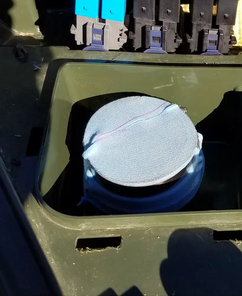

I use air filter oil on it. K & N work?
Smitty335 Well-Known Member Lifetime Member Supporting Member Oct 3, 2016 35,360 207,915 113 NWA Arkansas Ownership 1000-31000-5 Oct 8, 2017 #21 sporttrac4x4 said: I use air filter oil on it.View attachment 55845 Click to expand... K & N work?
sporttrac4x4 Well-Known Member Lifetime Member Jan 7, 2016 1,177 2,082 113 ILL. Ownership Other Brand Oct 8, 2017 #22 Smitty335 said: K & N work? Click to expand... K & N air filter oil. yes
sporttrac4x4 Well-Known Member Lifetime Member Jan 7, 2016 1,177 2,082 113 ILL. Ownership Other Brand Oct 8, 2017 #23 Maxima Air Filter Care Kit I use this.
G grizzly660fan Member Jul 17, 2017 50 86 18 Utah Ownership 1000-5 Oct 9, 2017 #24 sporttrac4x4 said: PC Racing Filter Skins I use a hose clamp to hold it in place. Click to expand... Which size? S,M, or L?
sporttrac4x4 Well-Known Member Lifetime Member Jan 7, 2016 1,177 2,082 113 ILL. Ownership Other Brand Oct 9, 2017 #25 Small or med. Both will work. Make sure you put a big hose clamp on it.
