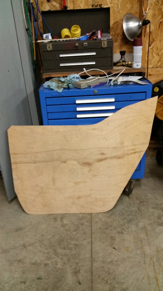

Cut a template for the skins tonight.
I am thinking way ahead hear but we should be able to offer custom door skins (your own design on the skins) that is one advantage to using vacuum forming. We can also use many different Color skins.
We will be ordering some tubing so we can start bending up a door frame.
hmmmm shape looks oddly familiar lol

cant wait to see how it comes together Chooglin.
After this fall I'm sure doors will be mandatory since we love those michigan fall rides but it can be cold and wet at times.
I've thought about making doors on and off but I'd have to start by making a whole door jam/filler attached to the rops then make a door that fit it and lose the suicide door hinges.I'll most likely end up with the fabric door kit just because that would be fast and easy and leave me more time for other wild unmade things for the P5.
Our P5 is up north until late october-early november then it will be down state here where I can work on it much more.
