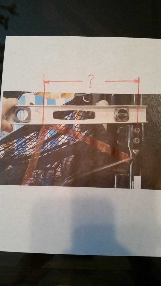

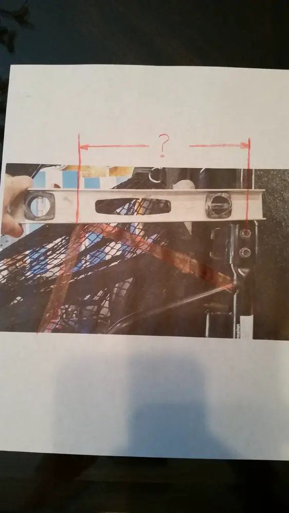

I need some help from someone that has a p500 with the new style restraint bar. Could you get a dimension for me?
I need you to use a level and set it on top of the Rops bracket with the two bolts (just like the pic). I need the distance from the center of the top bolt , to the intersection of the level and the outside of the restraint bar............thanks in advance.
NOTE : have your p500 on level ground when doing this !!!!
When I get by my buggy this evening I'll get it for you. Unless somebody beats me to it :)

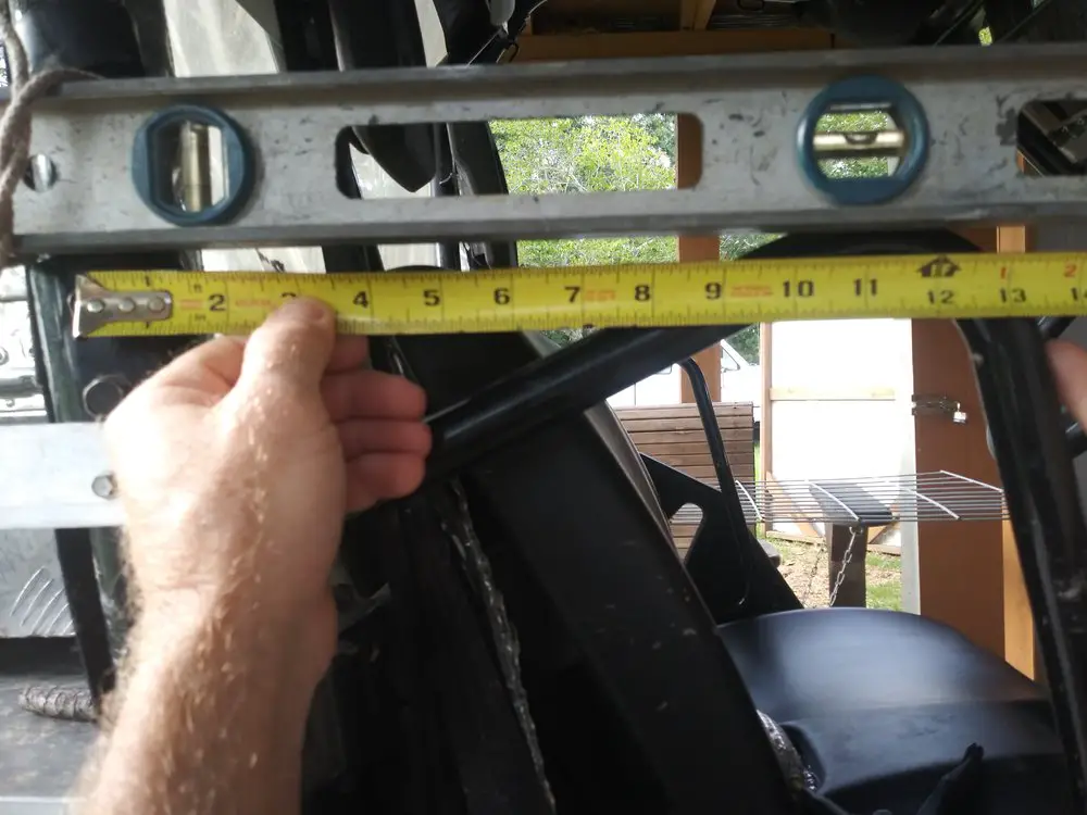

I'm going to call it 12 3/8 "
Hope this is what your after

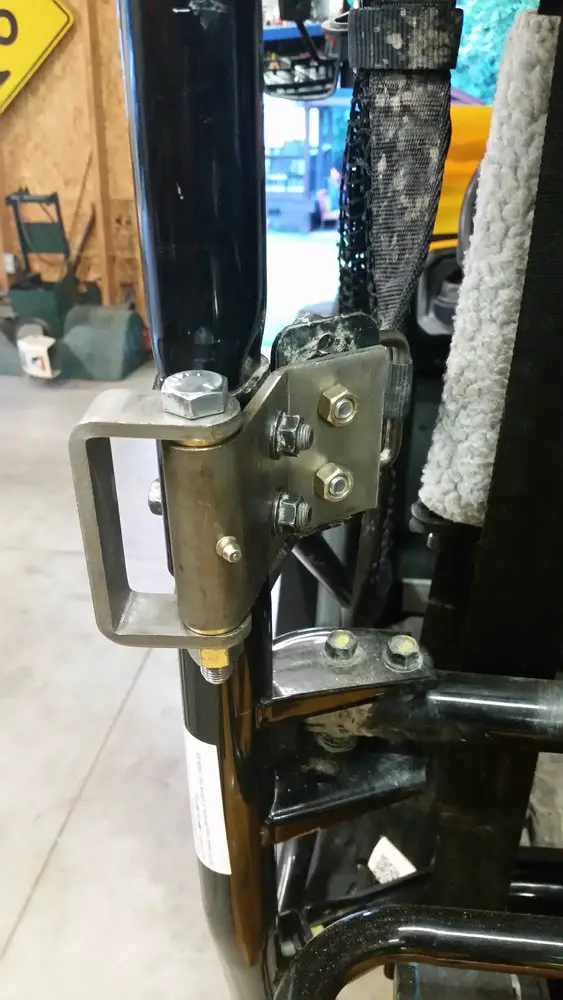

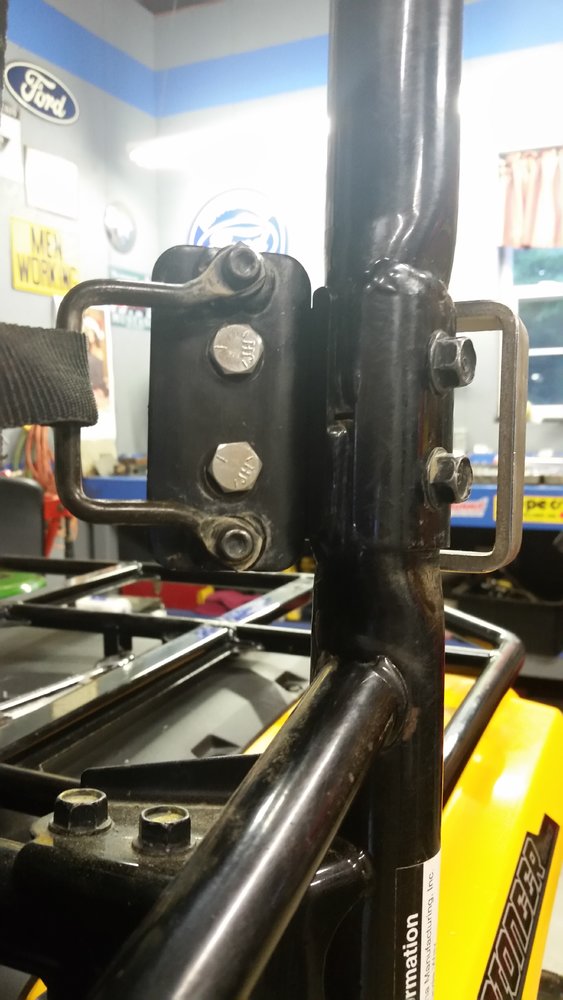

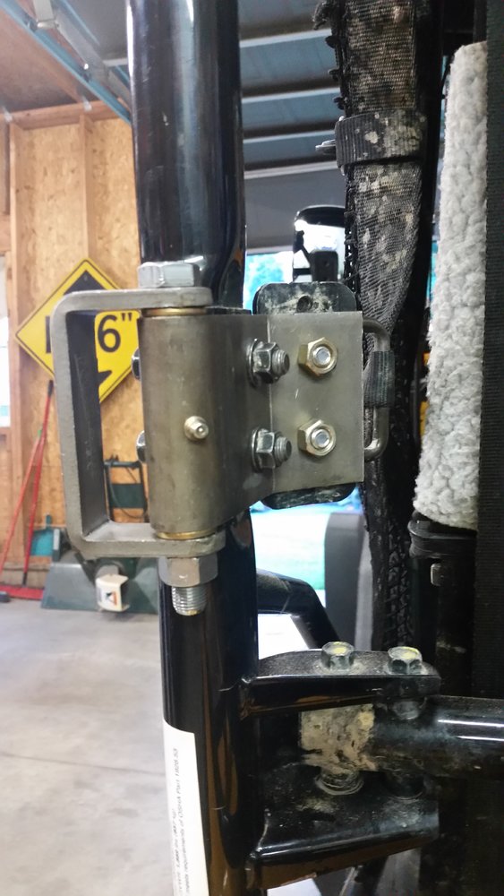

Wow, greasable too, that’s really sweet. Will the doors have two hinges?
It all depends on how much door sag we have. We will put some nylon bushings in the hinge first ,to remove any sag. If that doesn't work , (wich it should) then a second hinge could be necessary.
I would hope you end up with two regardless, the leverage against one is incredible, and one slip with the door in the open position where someone’s weight falls on it and somethings going to tweak.
