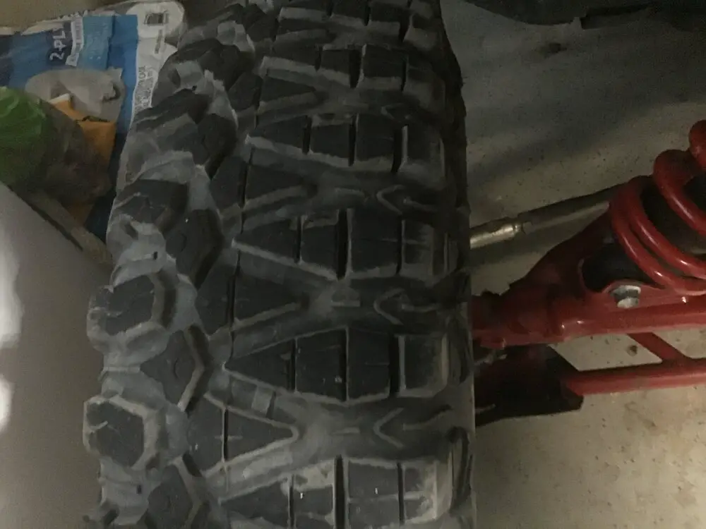

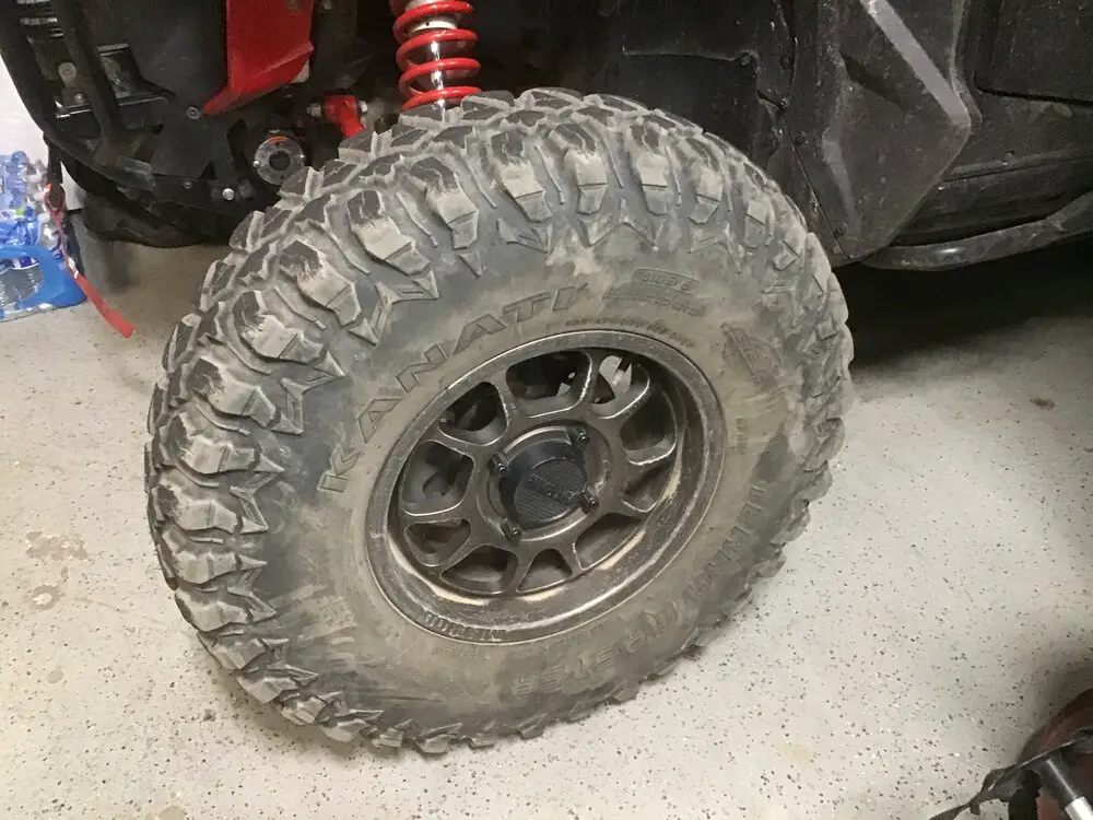

I run the 32” terramasters. Side B out. They work well on intermediate terrain and in the sand. Decent in the mud but not a deep mud tire. The tread is a soft compound and works good in the rocks. They are wearing fast. I am at half tread at 500 miles. The rears started chunking out at 250 miles or so. I run them between 12 and 15lbs. I dropped them to 10 and had a lot of squish or roll in the tires at higher speeds. 12.5-13 lbs seems to be the sweet spot for my terrain and a good balance of control and traction. I can say they have made it places my friends had to winch with the pro armor crawlers and carnivores. We have sharp hard rock imbedded trails and the sidewalls are strong, better than the 8 ply carnies.

I should add 98% dirt time. Very little pavement miles, pics are after a rotation.

I run the 32” terramasters. Side B out. They work well on intermediate terrain and in the sand. Decent in the mud but not a deep mud tire. The tread is a soft compound and works good in the rocks. They are wearing fast. I am at half tread at 500 miles. The rears started chunking out at 250 miles or so. I run them between 12 and 15lbs. I dropped them to 10 and had a lot of squish or roll in the tires at higher speeds. 12.5-13 lbs seems to be the sweet spot for my terrain and a good balance of control and traction. I can say they have made it places my friends had to winch with the pro armor crawlers and carnivores. We have sharp hard rock imbedded trails and the sidewalls are strong, better than the 8 ply carnies. View attachment 218203View attachment 218204
Thanks for the review! That was partly what I wanted to hear! 🤓 I was wondering how fast they wore out. I currently have a set of MRT Race tires that have been awesome on everything but how fast they have worn out. And the MRT's are super expensive. The Pro crawlers and the M1 Evils are some of the other tires I have been considering. I might still give the terror masters a try and see how they wear for me. The Terra Masters are less expensive then the other 2 options. The fourth tire I've been considering is the maxis roxzillas.... It is such a pain and expensive to find the right tire!(
