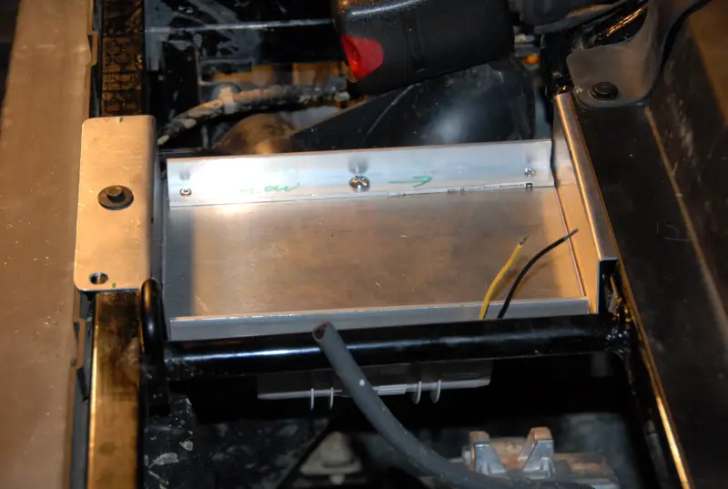

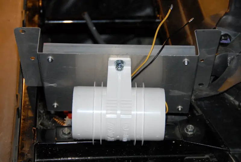

I made a thermal shield a while back,
and it helps, but I made a mount for
a blower today. I was going to build
in a polarity reversal circuit, but
it seemed easier to make the mount
reversible.
I'll work on wiring it up soon, and I'll
add a vent & some flex hose when
it starts to get cold this fall.
Eqv2gp
2rcwg2p
I captured the rear edge with the plastic
cover & push rivet, and added a second
push rivet up front so that it can be
easily removed for service.

Eltobgi
Eltobgi
Mar 21, 2016
4,599
15,187
North Dakota
reversible.
it starts to get cold this fall.View attachment 20270
Great idea on the blower. I also ordered
a rocker from OTTRATTW for it.
Later!
John
Very nice! The top of your blower mount can also act as additional storage. Great idea!
Johnny_C
Johnny_C
Nov 19, 2015
303
143
Western N. Carolina
Ditto! Nice mod. I'm going to make trays like that for all 3 holes when I can get around to it.
Good point. I am intending to add
some tupperware type containers
under the drivers seat, but a tray
over the fuel tank would be nice,
as well.
I did envision a small first aid kit
in the blower mount.
Later!
John
