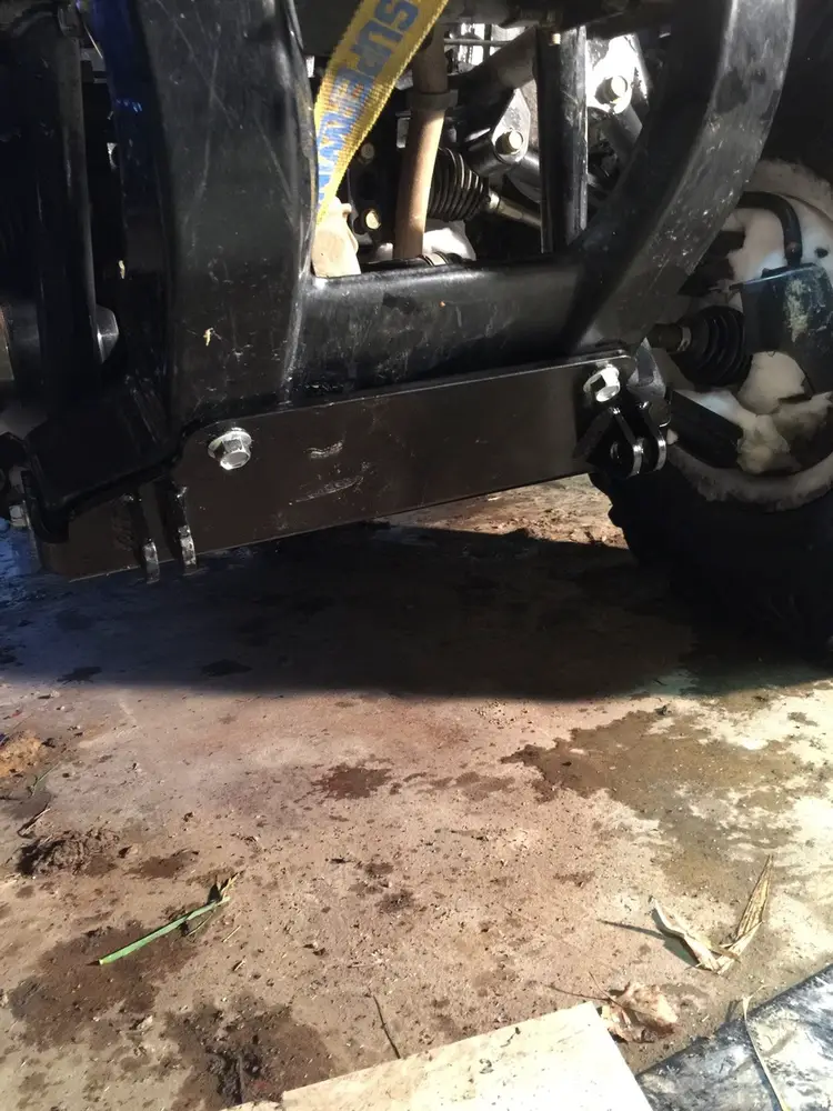

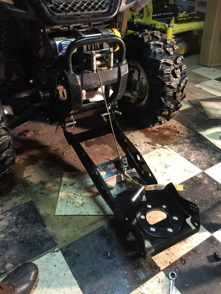

Having a high winch will not be an issue - the mount that KFI makes is high like your strongmade. The attachment point on the tubes (where the winch hook attaches) is adjustable so that you can change the angle of the cable. You have 4 different locations you can hook to in order to get the angle you want.
The bracket takes about 1/2 hour to install. You remove the two bottom bumper bolts. Loosely attach the bracket with those bolts. Mark the bumper through the holes in the mounting bracket. Remove bracket. Drill two holes through the front of the bumper where you marked (1/2" drill bit). Reinstall the bracket (4 bolts total). Tighten the bolts and you're done.
The blade comes with large shoes, and they are adjustable and replaceable.
The plow/push tube assembly installs to the bracket with two hitch pins. Haven't installed mine yet with the blade, but it appears to be very easy, since it's a front mount setup.
I intend to leave the bracket on at all times. There is no loss of ground clearance with it on there, and it's a very beefy piece of steel. It wont bend easily like the stock bumper.
I'll post a couple pics for you.

7b71b2302c8a0a013f68b3ca1ea805f5
51f0157fe1c0fb64e6069640256bec35

B9c2cbef2f6b06ee94ce6231a244ad79
Blade installed! KFI makes very high quality stuff!
And 66" is perfect for the 500. Plowed some snow tonight. Love this setup.

Really happy with it and the install is easy. I experimented pushing some really deep heavy snow. It's been on the ground for a few days so it's icy and hard to push. The high lift is really nice for piling the snow high.

I think having the winch up high is better for lifting and lowering the blade, better angles.
My KFI came with the skid shoes as well. I leave my mount on year round, doesn't effect ground clearance at all.
Keep blade on a piece of cardboard in garage when detached, makes it easier to slide around.
