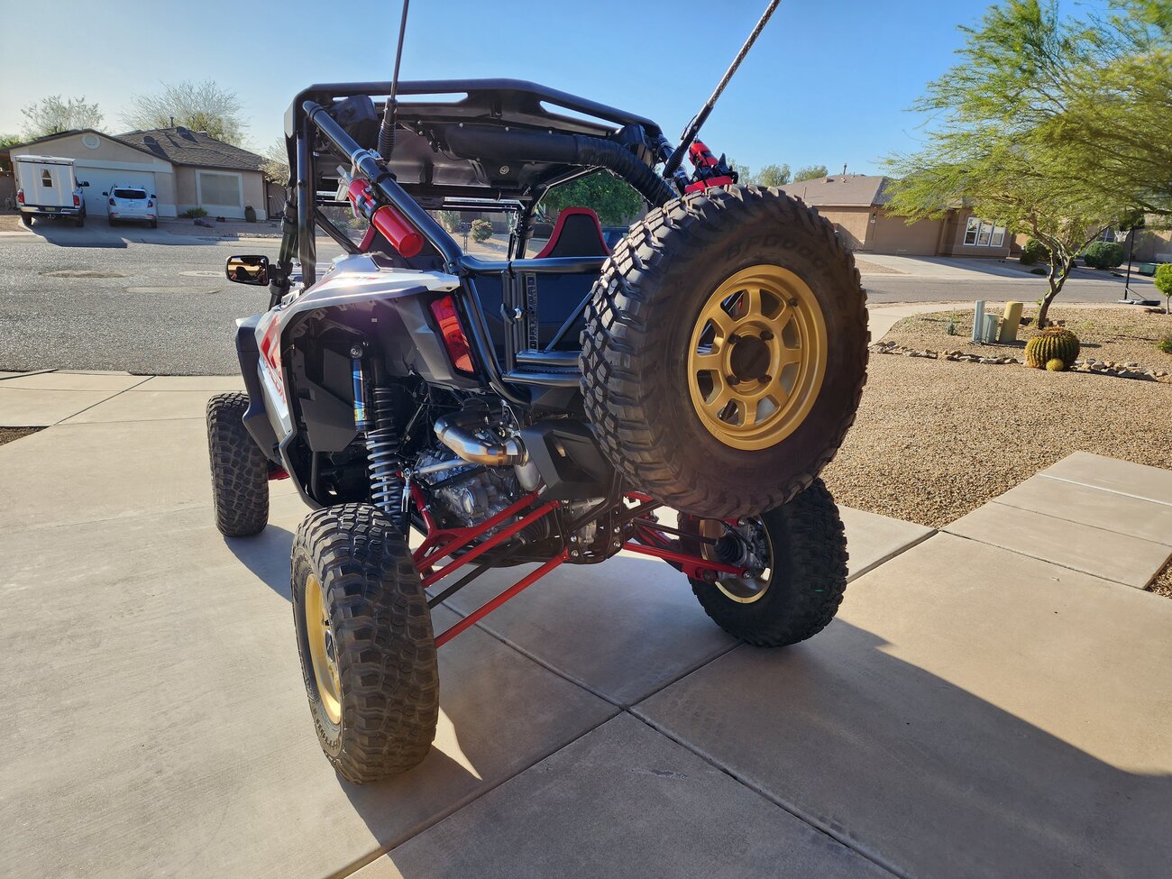

I had previously tried two types of spare tire carriers, the tube type that came with it, that I never liked:
Resize54

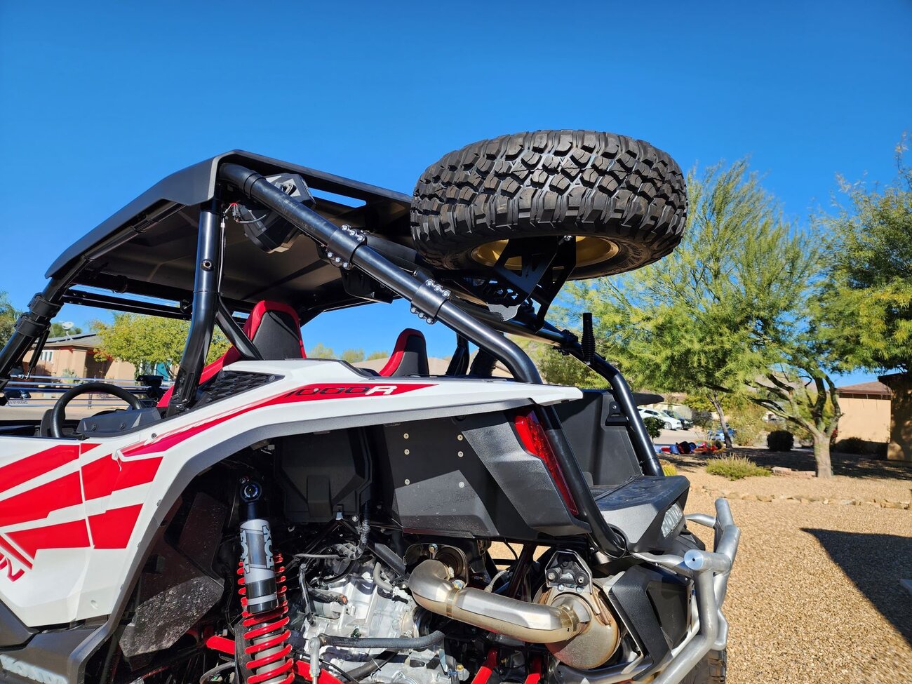

The second attempt was the Tusk model. It was very well built and looked decent. At this point I still hadn't worked out the whole chassis geometry thing and was still learning what caused the "bucking" that I encountered in large whoops.
Resize3

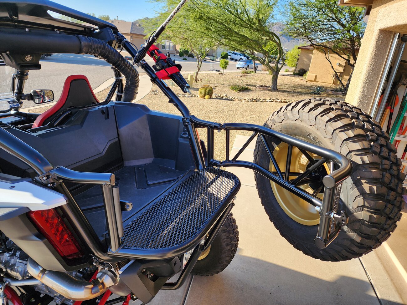

After working with Shock Therapy I got the suspension upgraded and that helped the bucking quite a bit, but it still wasn't at the point that I thought it should have been. That's when I really did the research and found out what was actually causing it to buck, it was the chassis geometry itself. I needed to take all of that weight from up high on the cage and move it as far back and as low as possible. So I bought the Dirt Road Fab extender to accomplish that. Ordered it with the expanded metal bottom and the low tire mount.
20230415 170550
20230415 170615
Resize51

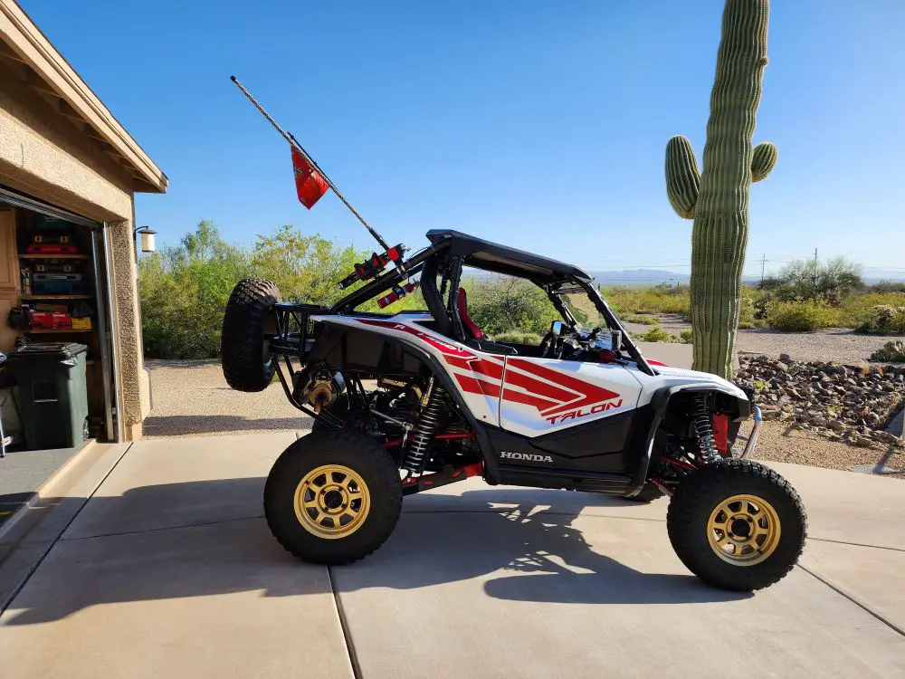

I had to buy a couple Axia Alloys 360 degree whip mounts for the cage, as I had the whip mounts mounted to the Tusk spare carrier and that was now gone. Kind of fiddly to get just right, but they are a clean way to do it and the result was worth the fiddling, IMHO.
I'm pretty content with the outcome. I did a quick test on a local section that always upset the car and made it really sketchy at 35 mph. With the new Dirt Road Fab extender and the lower tire mounting location, that is now gone. It will now handle that section at 50 mph and the car remains planted and stable. This product solved a couple, of what I considered, big issues for me and I highly recommend it. I also lucked out and it fits on my Big Tex 60PI trailer with 4 inches to spare to the tailgate ramp.
