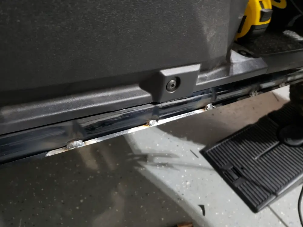

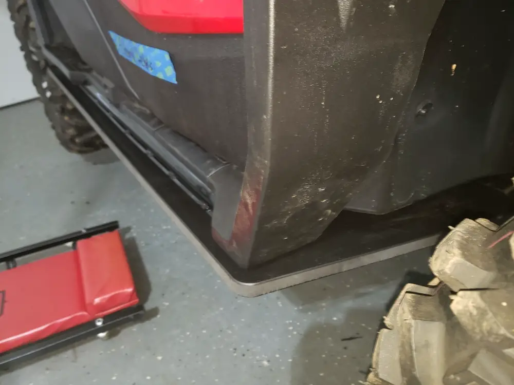

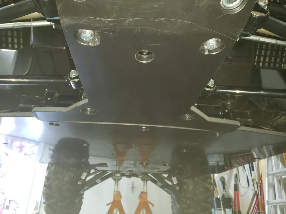

Just thought I would post a update on my DIY Skid Plate install. I had mine water jetted and milled by a buddies machine shop out of 3/4 UMHW ( he had a bunch left over from a big job and have me the material. I just paid for machine time so I could be the price and I figured a little extra strength can't hurt based on some frame damage I have seen) I also added a additional 1/2 to each side to protect everything. To install I welded in but to a Ruff Stuff tube gussets and then welded those to the outer frame members. I think it came out great. Now I just need to get out on the trials and test it out. Thanks again for everyone help on this, and to Bones for helping get the files to work in CAD.A24e210f5245e18b43f180351b4e7271Ab7d9c4487628be6dc1d1208314aacd91e47cdfc8ec13044dbd65d11f59bb5b0Ed82542df3dc233950f060241aaf32edFdae7de2de9684807082c9b3fe8ecf52

3/4 is a bit overkill but it looks really good. I couldn't believe how much stiffer the machine feels with the side tubes gusseted.

Thanks, Todd I got the tube guesset direction from your build. Should add quite a bit of strength and was super easy to add. I miss my old 2 post lift thou working under jack stands is no fun. I know 3/4 was overkill but the price was the same as a 1/2 sheet if I just purchased it. I figured a little extra weight that low couldn't hurt.

Just thought I would post a update on my DIY Skid Plate install. I had mine water jetted and milled by a buddies machine shop out of 3/4 UMHW ( he had a bunch left over from a big job and have me the material. I just paid for machine time so I could be the price and I figured a little extra strength can't hurt based on some frame damage I have seen) I also added a additional 1/2 to each side to protect everything. To install I welded in but to a Ruff Stuff tube gussets and then welded those to the outer frame members. I think it came out great. Now I just need to get out on the trials and test it out. Thanks again for everyone help on this, and to Bones for helping get the files to work in CAD.View attachment 168460View attachment 168461View attachment 168462View attachment 168463View attachment 168464
Good idea on adding the .5" and gussets. That thing is bullet proof. Very nice job!
