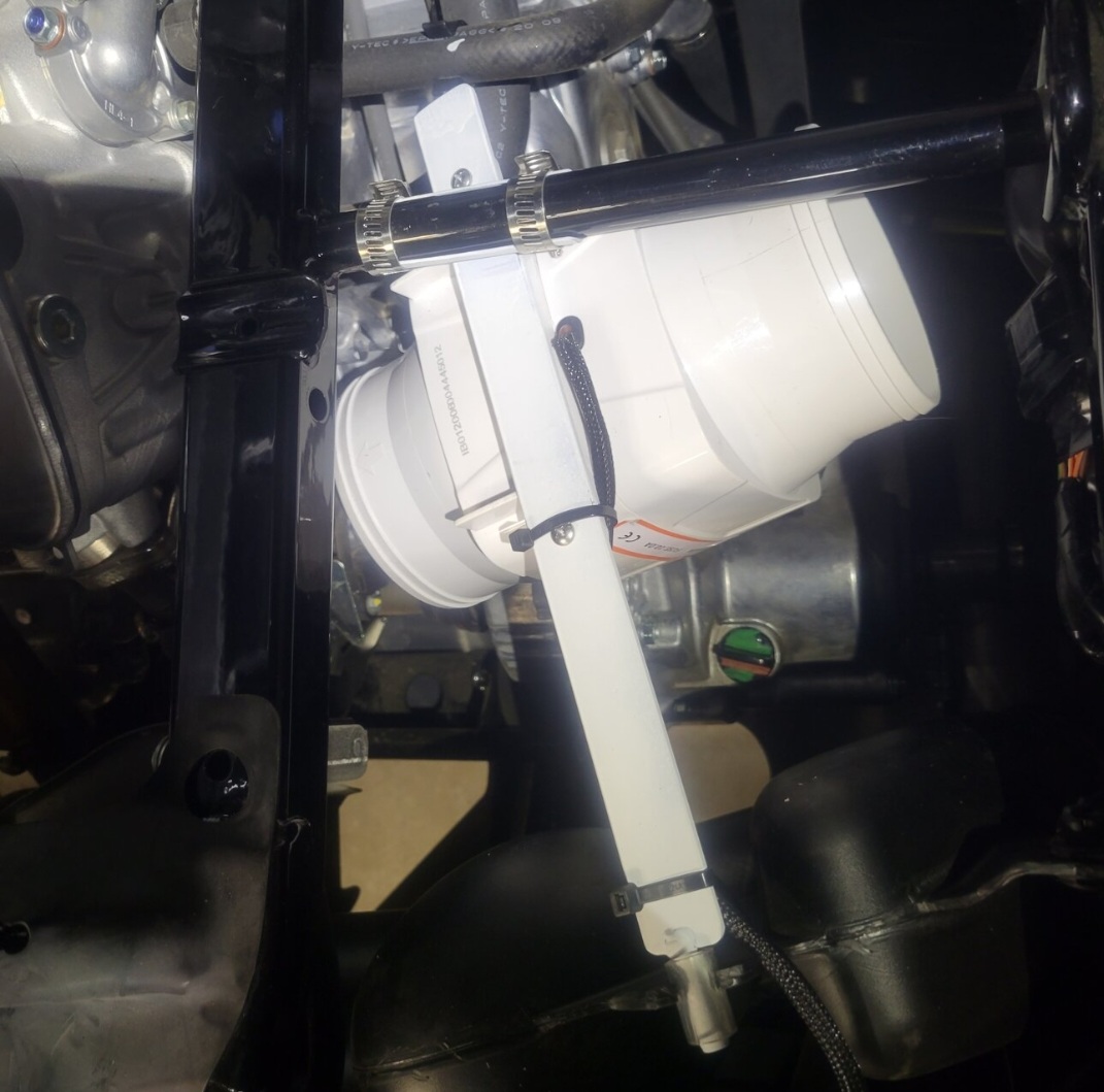

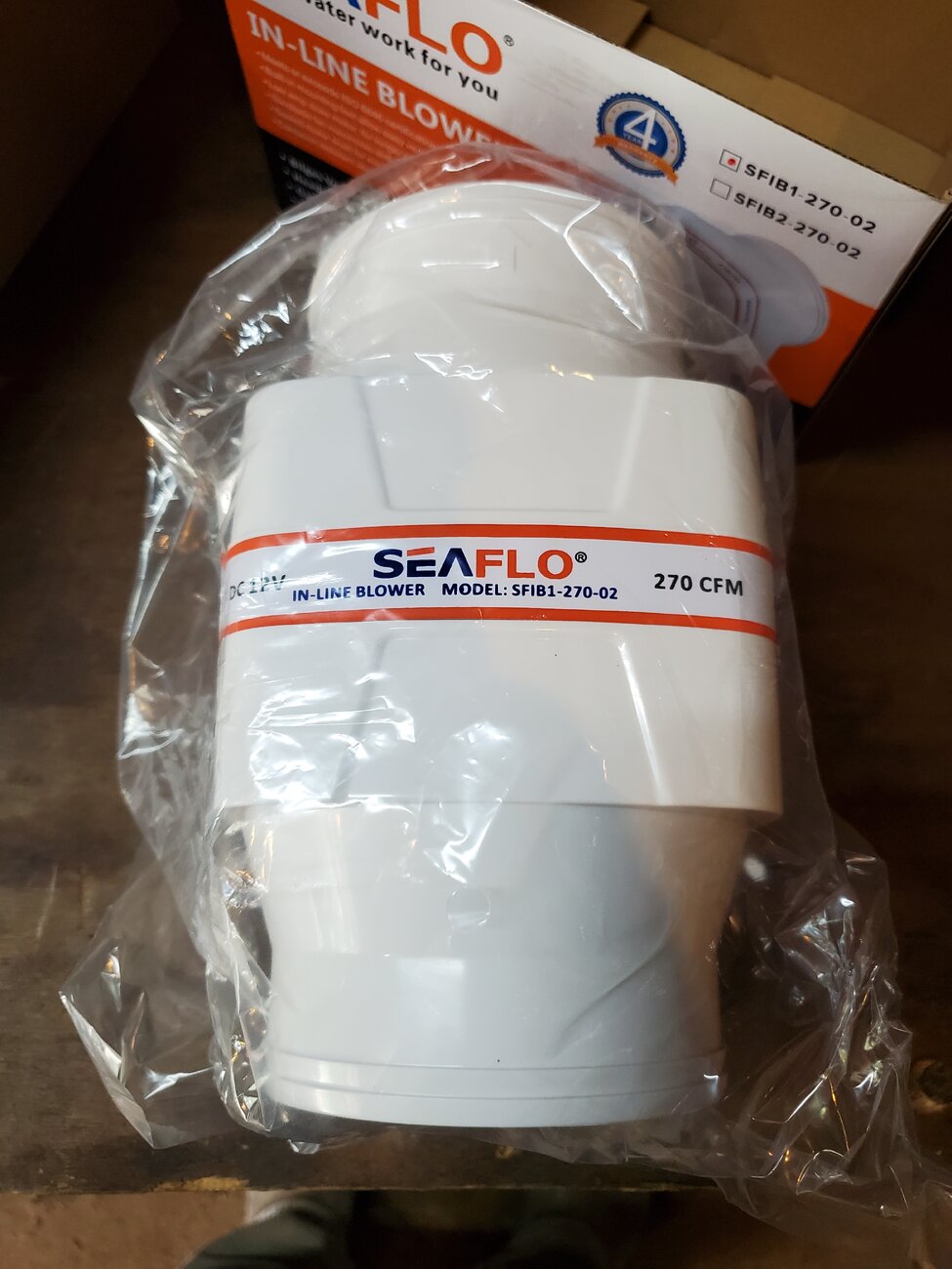

I put the quick shield and a bilge fan in mine. Copied how @bumperm did his fan. I highly recommend doing both.
Fan from Amazon
20220416 155609
Install pic of @bumperm machine
Fan from Amazon
Seems to be a popular mod. I used an Attwood blower
