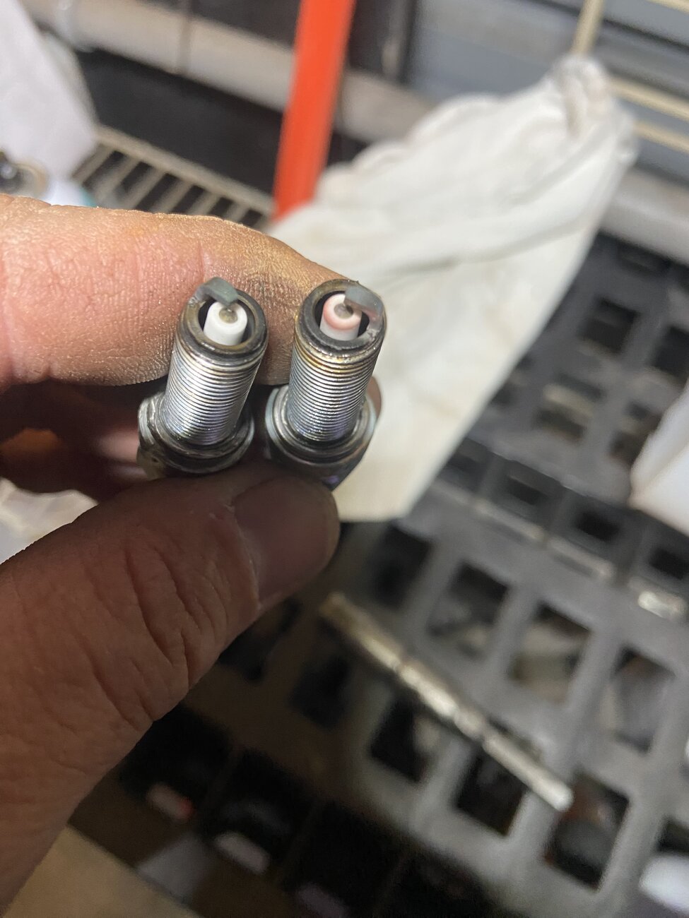

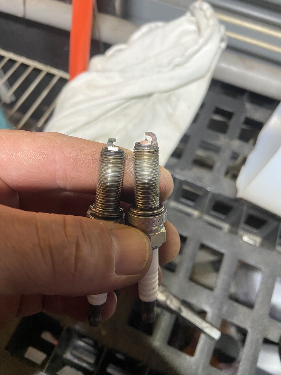

If its the injector wire and the way that bugger misses Im willing to bet that plug is fouled all to hell cuz of it. See it all the time on Generators I work on every day. $hitty ignition causes plugs to foul. Your on the right track
Here’s the old spark plugs. The plug on the right is the #2 spark plug.
I did replace them both this evening.

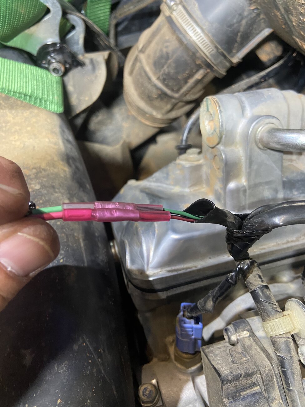

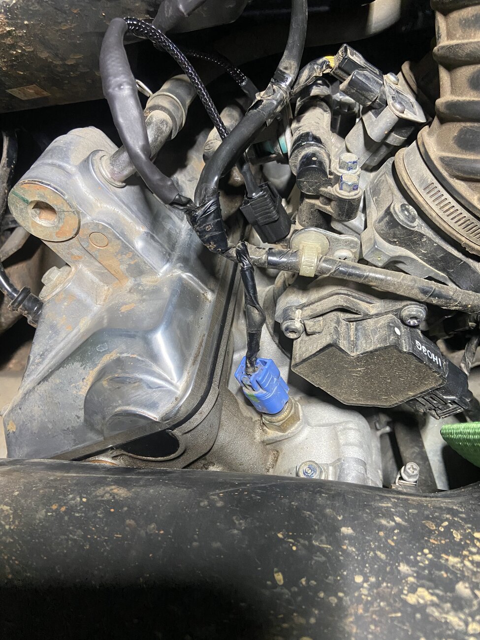

This evening I replaced the spark plugs, and replaced the fuel injector plugs.
It now runs on both cylinders, the way it should! I’m going to change the air filter since I have the shrouds off and it’s easier to access in its current state.
IMG 0429
This was the #2 injector plug, the wire just pulled out when I unplugged it from the injector.
IMG 0433
Got it connected and heat shrunk with the supplied connectors from the club store.
IMG 0435
Both are connected and working properly.
IMG 0436
All installed, not sure about how loose or tight the wires should be, I’m considering leaving them like this. Any thoughts or suggestions on how to tie the wires up?
It now runs on both cylinders, the way it should! I’m going to change the air filter since I have the shrouds off and it’s easier to access in its current state. View attachment 420448This was the #2 injector plug, the wire just pulled out when I unplugged it from the injector. View attachment 420449Got it connected and heat shrunk with the supplied connectors from the club store. View attachment 420450Both are connected and working properly. View attachment 420451All installed, not sure about how loose or tight the wires should be, I’m considering leaving them like this. Any thoughts or suggestions on how to tie the wires up?
Great job. I would leave them loose as long as they aren’t rubbing somewhere.
Awesome, glad that was the fix 👍 thanks for reporting back.
I wouldn't stress the wires as long as they're not in the way of anything else they should be fine they way they are up there. 🤘

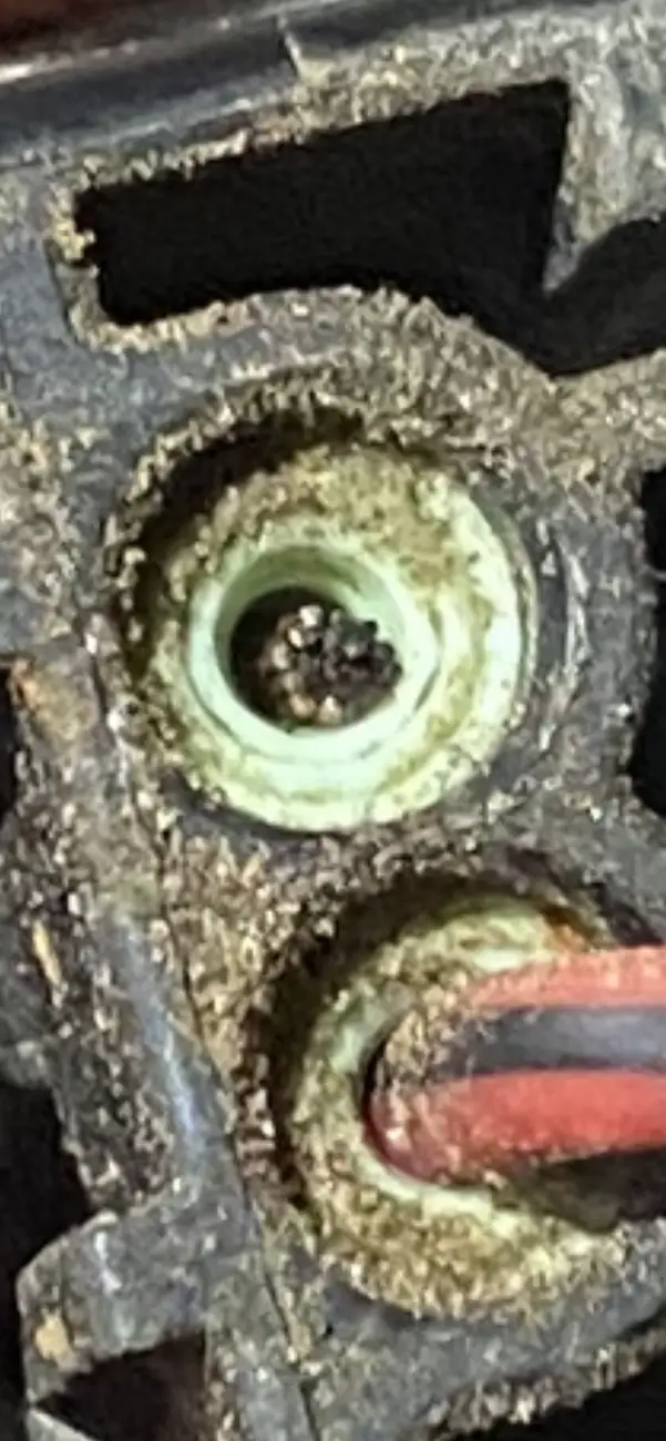

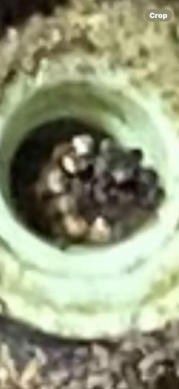

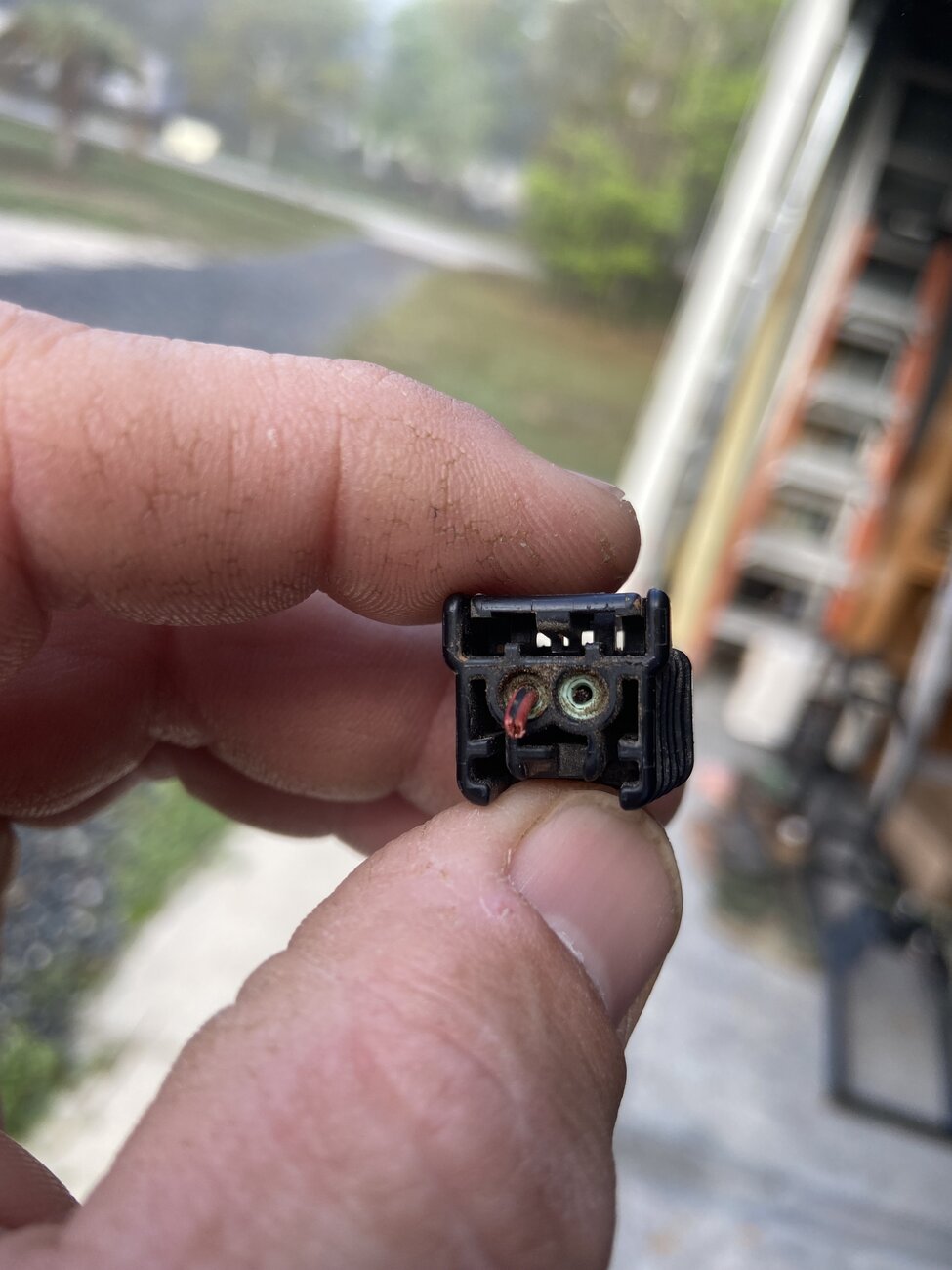

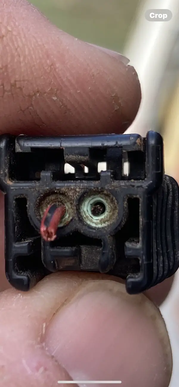

This morning I was able to look closer at the old injector plug end, and it looks like the outer 6 strands in the green wire were what was holding it together, and the others looked cooked. Maybe from arcing while running?
IMG 0437
IMG 0439
IMG 0447
Thanks y’all for the support.

This morning I was able to look closer at the old injector plug end, and it looks like the outer 6 strands in the green wire were what was holding it together, and the others looked cooked. Maybe from arcing while running? View attachment 420481View attachment 420482View attachment 420483
Thanks for keeping the thread updated and the video/pics with solution. Lotta people just go dark after we help and never report back for the next guy in need of a fix for similar issues.
Glad you got it going again 👍
