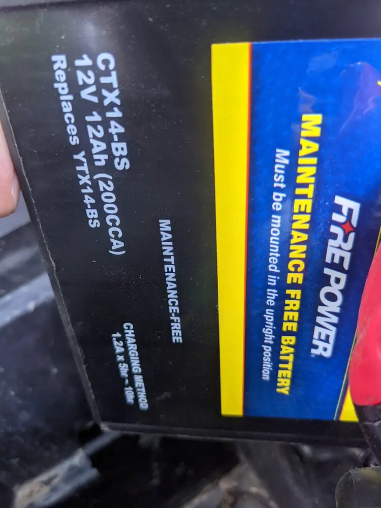

Dealership called, said they found a loose ground wire (neg terminal) on battery.
Only took two trips and a month of troubleshooting.
Check out the $75 battery they installed + $90 for an HR labor.
($40 battery on Amazon)
I expected an OEM battery from the dealership, sheesh.
The hold down strap wasn't even on the new battery. Guys, avoid this place. My butt hurts bad. I suspect the original problem still exists.
I'll get to drive it this weekend.
I would refuse that battery for that price and any labor.
They are the ones who caused the problem, and a Honda battery isnt anymore than that POS.
