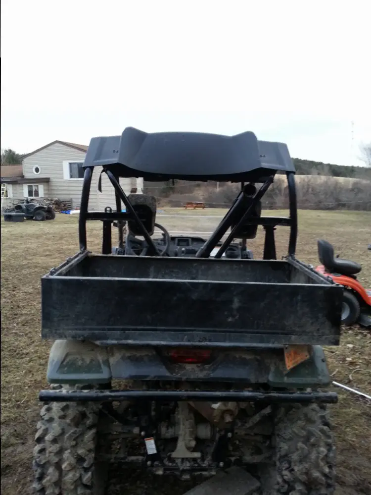

How did you fasten the PVC pipe to the rubber elbow on the filter box? Is it just pressed in there?
sthomp54 Well-Known Member Jun 11, 2015 356 375 63 Feb 21, 2016 #21 How did you fasten the PVC pipe to the rubber elbow on the filter box? Is it just pressed in there?
jak9922 hot headed wopolock Vendor Lifetime Member Jun 2, 2015 3,283 5,636 113 pittstown ny Feb 21, 2016 #22 Alot alot alot of pvc cement shes air tight and not going any wheres
JACKAL Ancient Honda fanboi Moderator Lifetime Member Supporting Member Club Contributor Jun 11, 2015 39,982 273,578 113 Pioneer, TN Ownership 1000-5Talon X4 Feb 21, 2016 #23 jak9922 said: .View attachment 10660 Start to finish 2 hrs Click to expand... Looks Good @jak9922 now your all set to relive your coast guard cutter / P500 ice breaker episode. Reactions: jak9922
jak9922 hot headed wopolock Vendor Lifetime Member Jun 2, 2015 3,283 5,636 113 pittstown ny Feb 21, 2016 #24 I hope that never happens again lol
C Chris863 New Member Feb 14, 2016 5 0 1 Bartow Feb 29, 2016 #25 jak9922 said: .View attachment 10660 Start to finish 2 hrs[/QUOTEdid u build the box on the back and how did u attach it to the rack ?? Click to expand...
jak9922 hot headed wopolock Vendor Lifetime Member Jun 2, 2015 3,283 5,636 113 pittstown ny Feb 29, 2016 #26 Yes I built the box on the back and I drilled through and bolted it onto the rear rack with 4 3/8s bolts
C Chris863 New Member Feb 14, 2016 5 0 1 Bartow Feb 29, 2016 #27 jak9922 said: Yes I built the box on the back and I drilled through and bolted it onto the rear rack with 4 3/8s bolts Click to expand... Did u build it out of metal or wood ??
jak9922 hot headed wopolock Vendor Lifetime Member Jun 2, 2015 3,283 5,636 113 pittstown ny Feb 29, 2016 #28 Metal it's all 1 1/4 angle with 1/8 plate
