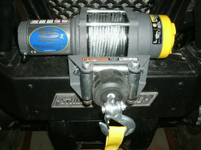

I bought the Super Winch kit towards the end of last year. I mounted the winch to the SM bumper, but didn't get the wiring done before the cold weather set in. Yesterday evening, gave her a quick bath and put her up on the ramps, removed battery box cover and main skid plate, in prep for wiring.

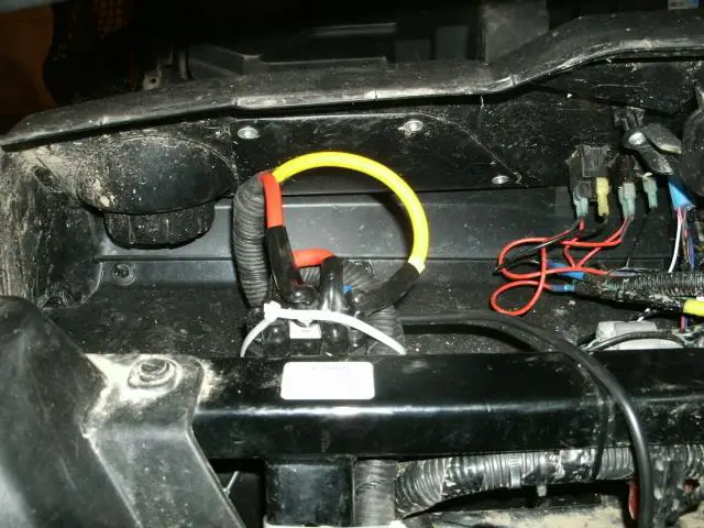

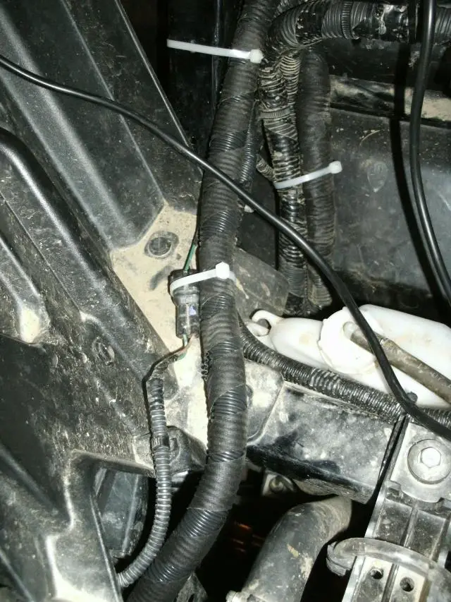

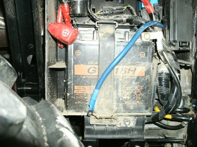

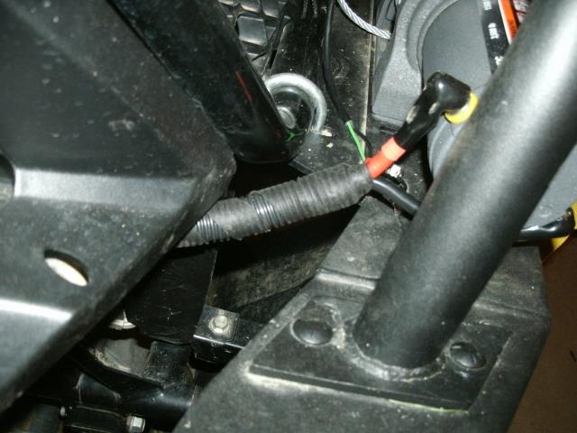

I finished up the heavy duty wiring this evening. Here are a few notes for those considering or yet to install this kit:
- 3/4" loom tubing was sufficient size to fit both 6ga wires in. I went thru a roll of 10' for doing both sets of wires.
- There is an OEM bracket welded to the square tubing where the oem winch relay is suppose to go. Upper left corner under the hood. I almost missed it and would have drilled two holes in the tubing. Hole spacing for the Super Winch relay is the same as the oem. :)
- The blue or yellow wire is slightly short from reaching from the positive battery post to the relay. I attached the red short lead to make it long enough. This would be the same for CB mounted to positive battery post, or wiring direct to the starter relay, like the oem kit does.
- The other wire for the negative is long enough since it is mounted closer at the ground junction.
- Speaking of the blue and yellow wires, from a color coding point of view, it would be better that the yellow is positive and blue negative, like how it would be to the winch motor. I noticed this about 3/4 of the way done, so my positive is the blue cable. ;)
- The red and black wires were just long enough to reach from the relay to the winch motor. My winch is mounted higher than others being on a Strong Made bumper. They may be too short for mounting a motor low, like the oem position.
PS: I have some pics to post, but my host is having some issues currently.
