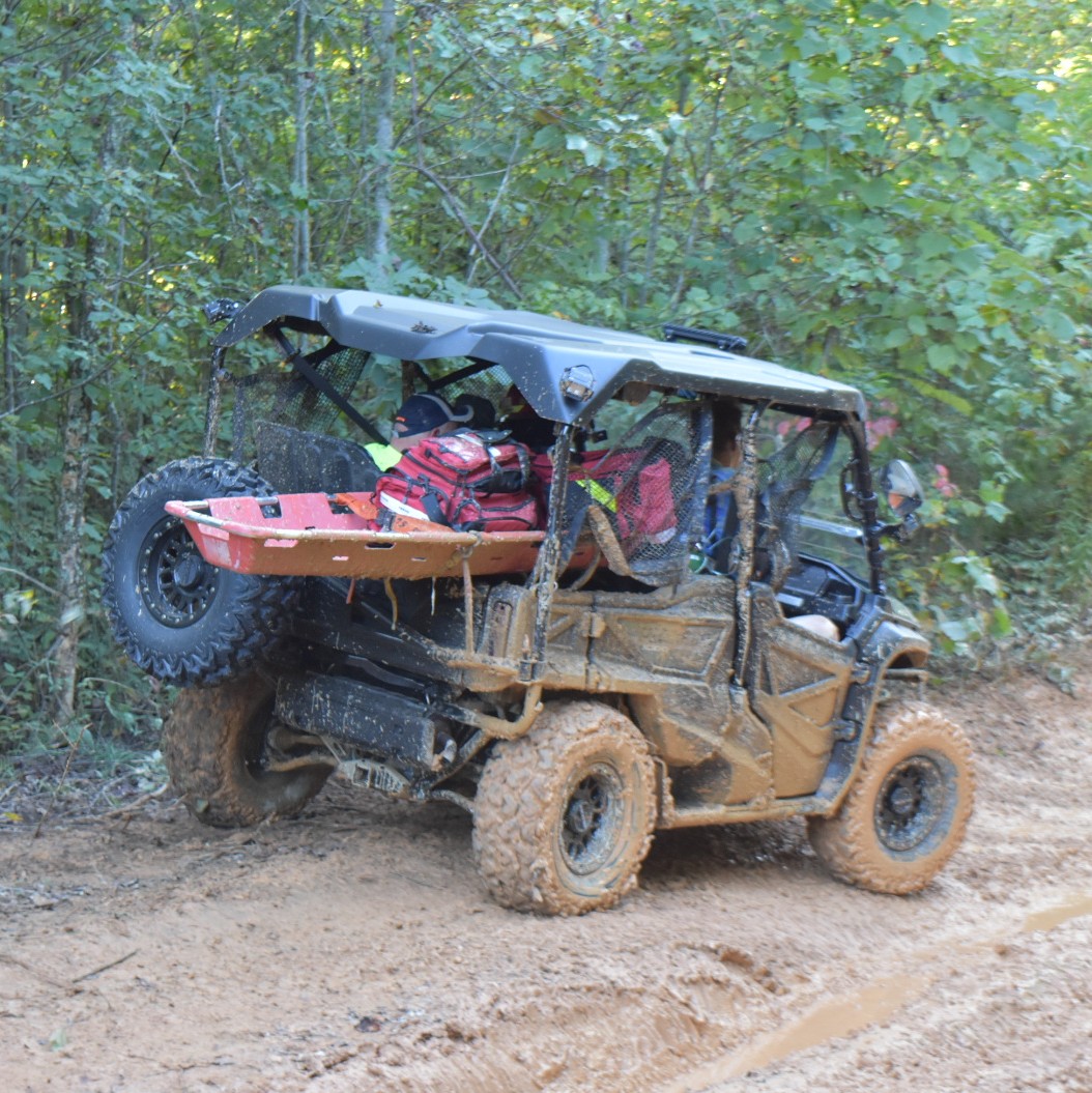

The plan is to primarily have an EMS/Rescue setup with a quick change for any fire response. Inventory will be pretty lite just based on space and weight. 3 person crew with 2 in front and 1 in the right rear. The left seat folded will be where the patient will be transported in a stokes basket when needed. The plan for the tray is to have medical storage underneath. Also with the bed extender we'll have extra space.
Royal Blue Rescue in TN has a nice rig with similar set up 👍
