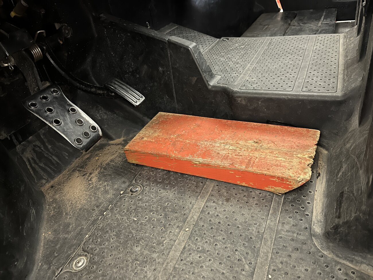

Shortly after getting my P1K-5, I experienced difficulty in maintaining steady throttle when on rougher ground, OR after driving for more than 15-20 minutes I would get cramps and ache from my throttle foot/leg.
Before I found this site, I tried a couple of things, before I discovered that adding a piece of 2x6 under my accelerator foot area, made a WORLD of difference. To keep it in place, I cleaned the floor, and added velcro to both the piece of wood, and to the floor, so I can remove it if necessary for cleaning, maintenance, etc. It's been in the SxS for nearly 5 years with no issues.
The piece I used, just happened to be one of the stack of similar boards I use for our camper for leveling purposes, thus the orange paint I added, to make them visible when picking up and departing campsites.
Cheap ands works great.

Shortly after getting my P1K-5, I experienced difficulty in maintaining steady throttle when on rougher ground, OR after driving for more truant 15-20 minutes I would get cramps and ache from my throttle foot/leg.
if u paint it red - will add 15HP - don't need to spend any more money that that to fix the problem
I see why that fix is too complicated for Honda.

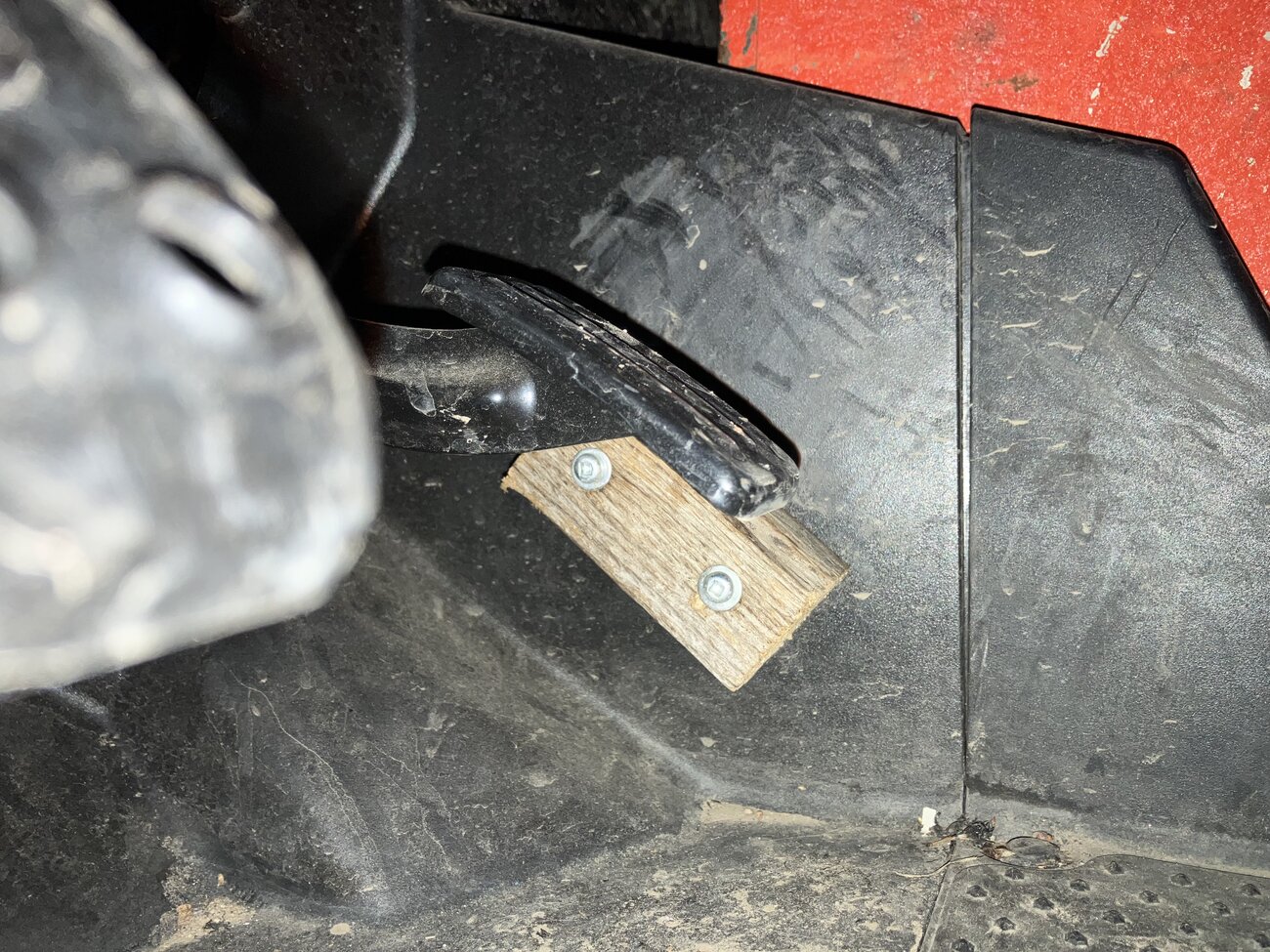

My simple fix that's cheep, easy and very effective; a 2"X 2" screwed into place when foot is level while at most common position. Many vintage cars had a foot support like this to rock the foot sideways for effortless throttle control.
That is way too complicated for Honda to do something about, after 10 years of production.
