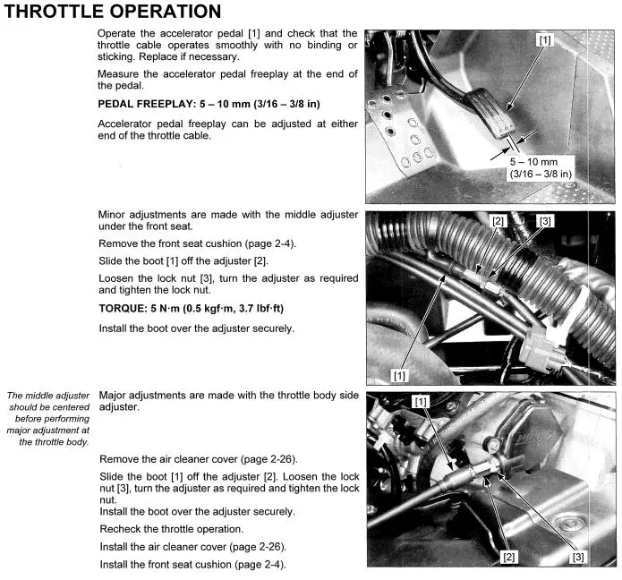

Here is a screenshot of the throttle adjustments.
I tried following the user manuals instructions for adjusting the throttle, but could not find the adjustment referred to in step 2 minor adjustments. I did perform adjustments on the other, and it seemed to help.
Reactions: Plumber32

Next time I am near my machine, I will look under the seat and take a picture of it if I can find it.
