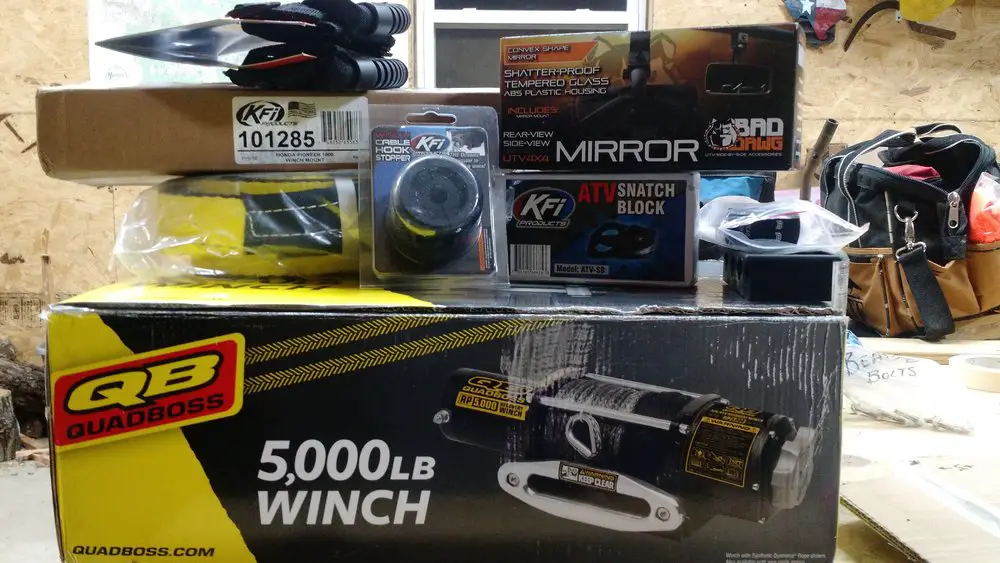

This was a pleasant surprise to come home to tonight!! Wasnt supposed to be here till next week.

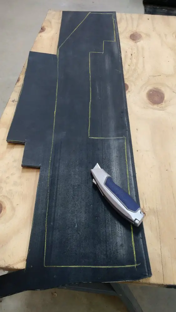

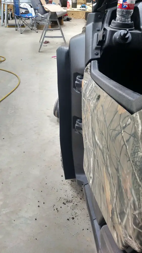

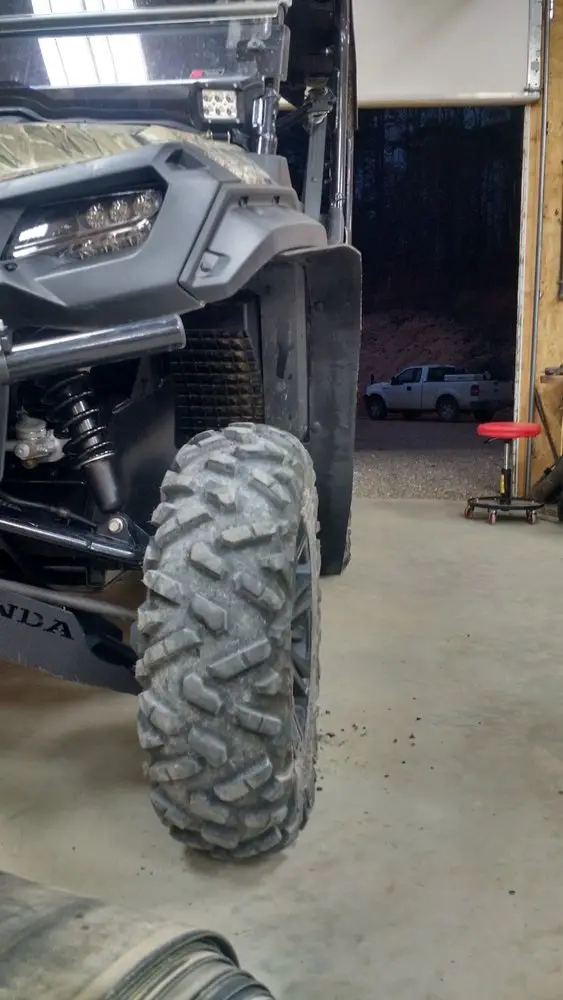

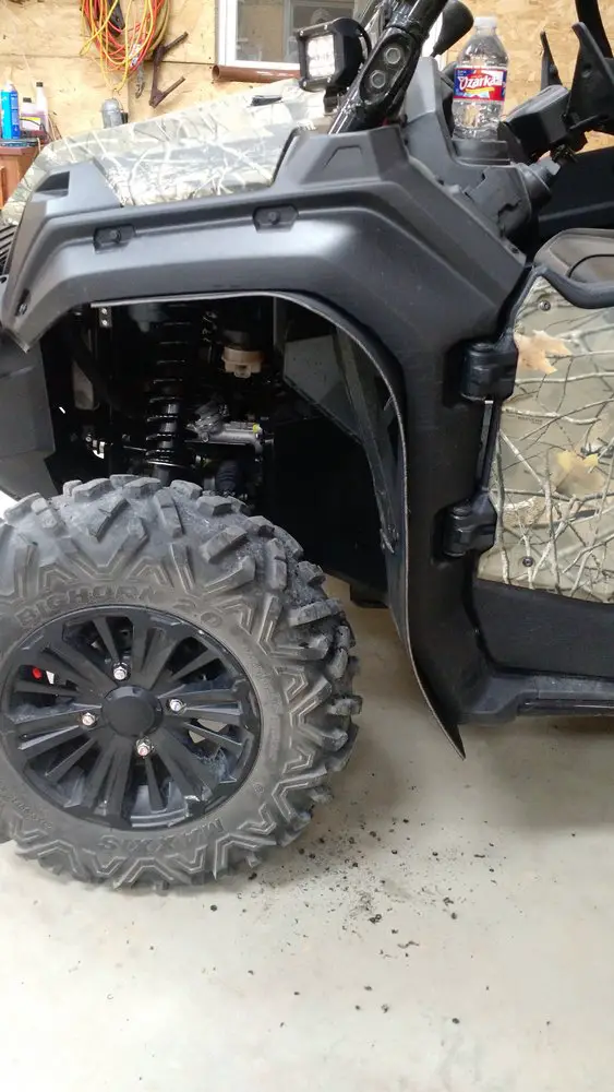

Made some fender flares out of some 1/4 in conveyer belt. Only fronts right now. Back flares are proving to be more of a challenge due to the doors and bed tilt. They are tough! Probably tear the whole fender off now.

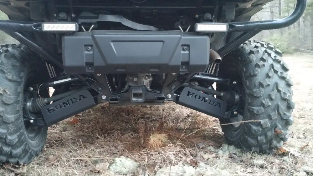

Put in some new rear work lights. Like having the lower ones that come on in reverse but wanted a switched light as well up high.IMG 20170318 144557979
Put in a new review mirror too.

Thanks. Winch install was super easy..Bolt kfi mount to frame, winch bolts to plate, plate to mount and tighten it all down. Ant the QB is all color coded but I had to switch cables around
They had @drfubar 's wires backwards too. Must be a qb thing lol
The only thing I can figure is I guess they want you to mount the contactor right next to the winch. But switch the cable around and works good!
