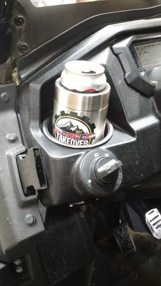

Cup holder mod complete!
IMG 20170519 192941606
20,363
116,574
Do you have to cut around the dash some to get these to fit? I see tons switching to them. Be nice to carry my yeti can cooler and tumblers.
I used a utility knife. After you take the old ones out, lay the new ones upside down over the existing hole and trace them out with a sharpie then cut about a 1/4" inside that mark.

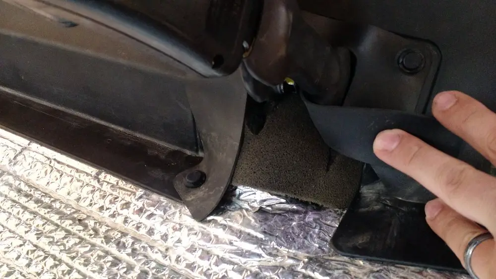

So I spent a few hours putting this sticky heat/sound barrier on the middle part of the seat. After talking to Joey a finding out it doesnt help much I went for a ride .....I'd say it doesn't hurt but no it didn't do what I thought it would. IMG 20170520 130601746 HDR IMG 20170520 150612730
I shoved the two small pieces of foam that were stuck to the back around the seat belts. I ordered the heat shield material that @JACKAL used and another 4in blower.

So I spent a few hours putting this sticky heat/sound barrier on the middle part of the seat. After talking to Joey a finding out it doesnt help much I went for a ride .....I'd say it doesn't hurt but no it didn't do what I thought it would. View attachment 44167 View attachment 44168

The stuff I added to that section of plastic didn't help mine hardly at all. I may try what you and Jackal use after I see how you like it. And yeah, you're my guinea pig lol. Also may install the header wrap I bought last year finally. If I can convince myself it's worth it to remove every now and then to remove the moisture buildup lol.

I did thing with the cool it wrap. I think it's helped some not as much as I was hoping but didn't hurt. I definitely noticed that it helped most when I wrapped the underside of the seat with it, and only one 4" blower, no insulation either and seat stays cool. Also no more moisture under or in the seat anymore. Just my 2 cents. Your build is coming along nicely
The header wrap just seems like too much work too me. If I was gonna do anything I think I'd ceramic coat them. I think the stuff I ordered will pretty well take care of it.
Thanks! I have the heat shield under the seat and one blower. They do good I'm just looking for better.lol
