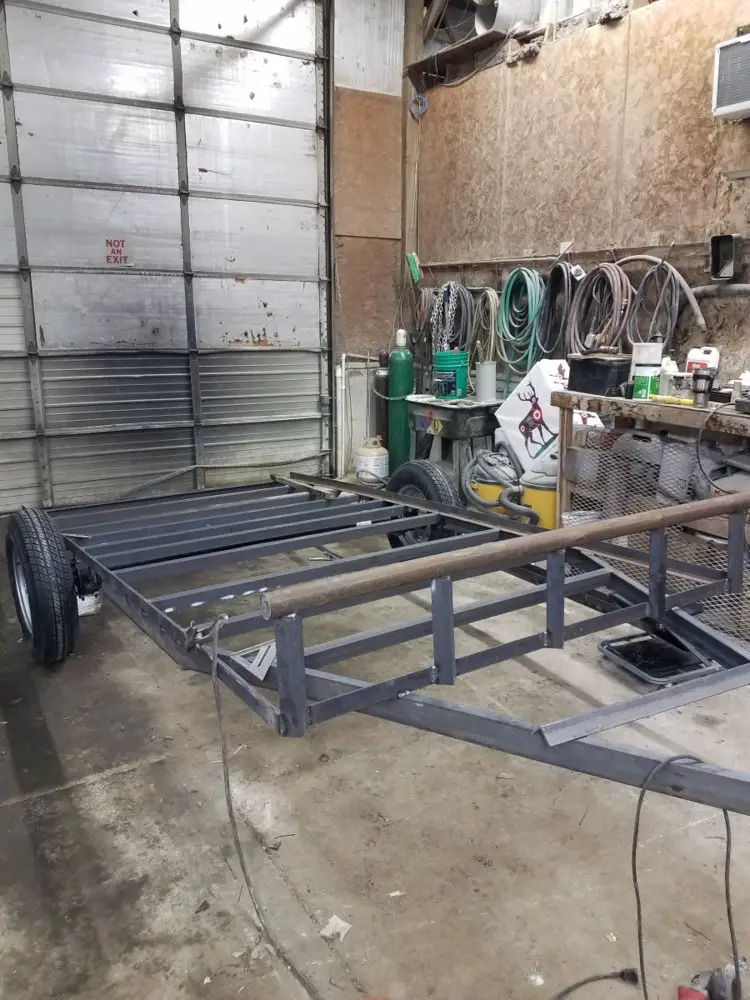

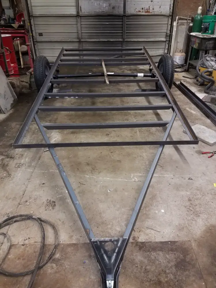

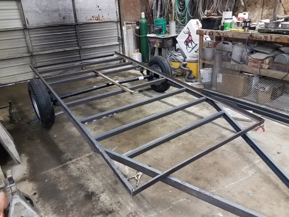

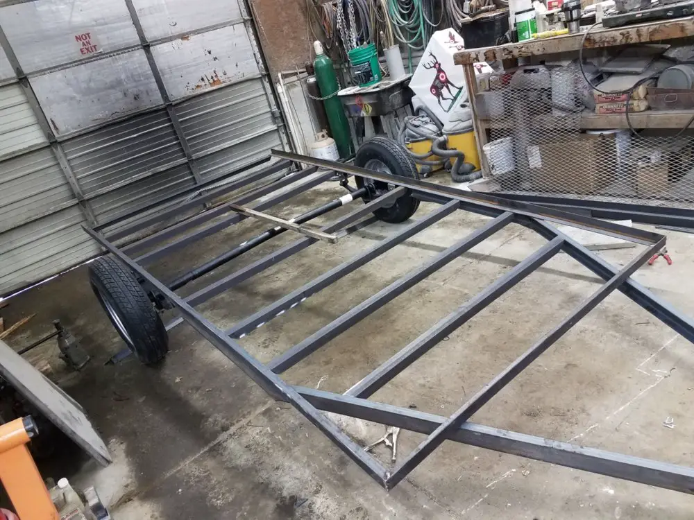

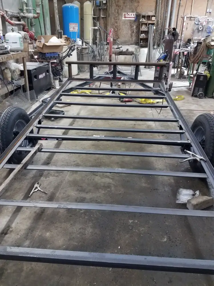

Got a good start on mine today. Looks big, but it's only 6 X 12. No railing on the sides. I hate railing. Then I can side load my golf cart or ATV. A little black paint, fenders and some 2 X's, and it'll be good to go. After all said and done, it should be right about $700.00

tough to find one without a rail, mostly why I built mine too and I just like building stuff. over 7x18 made of c channel, two 3500 dexter spring over ezlube breaking axles, I can put three or 4 quads on the side or tractor. all the ones that I looked at were too low or you would have to load it from the back or both. also 3-4k and I had about 1500 into it, majority of that being the dexter axles but I wanted something that would last and be easy to maintain

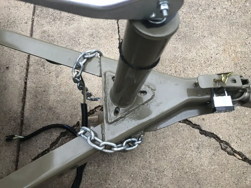

Well Chit! New trailer and already jacked it up.. Apparently the tongue jack back out while driving to our hunting property this morning and when I went to drop off the wife in Waco at her friends house we drove through a dip in the intersection of a 4 way stop and BAM I heard something hit hard..
Yep jacked up the jack.. Dammit!! I would just replace it but I have to ask the question to those who build trailers why in the hell would you weld a bolt on tongue jack? They get damaged more often that not and it would make it a whole lot easier to just remove 3 3/8" bolts and pop a new on on.. View attachment 106200
It ain't a trailer until you've bent the jack. It took you damn near a week. If you have a grinder it will take you about 20 minutes to grind the weld out.
OR>>> Load your SXS and connect the winch to the top of the jack. Winch it back upright. Use a snatch-block if your winch doesn't have the strength.
Actually less than 24 hours.. Picked it up at 1PM That Saturday and bent it around 10:30AM Sunday morning.. My mother told me a LONG time ago I would tear up a steel ball with boxing gloves..

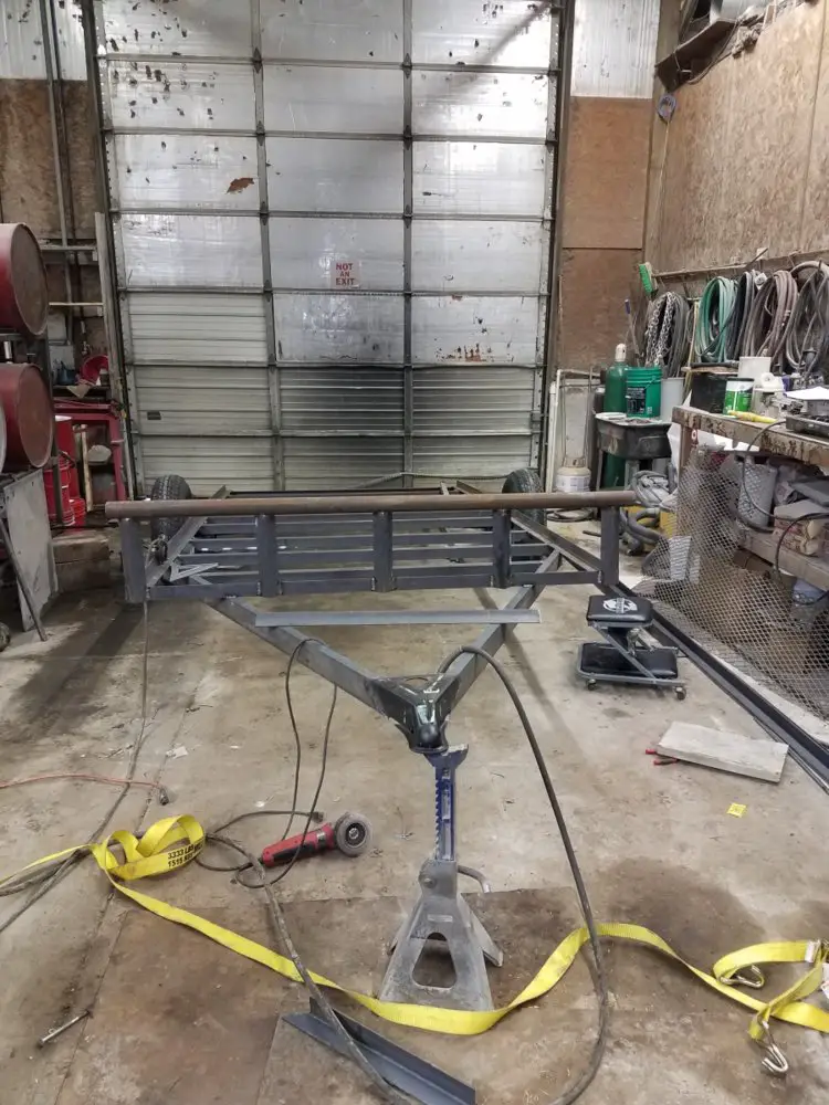

I changed my mind on my trailer. I didn't think it was rigid enough, so went ahead with a rail. It really is too long for a single axle, but I'll be pulling it behind my 5th wheel travel trailer.
Hey look! Bolts!

Sorry the hijack your thread Ken.
