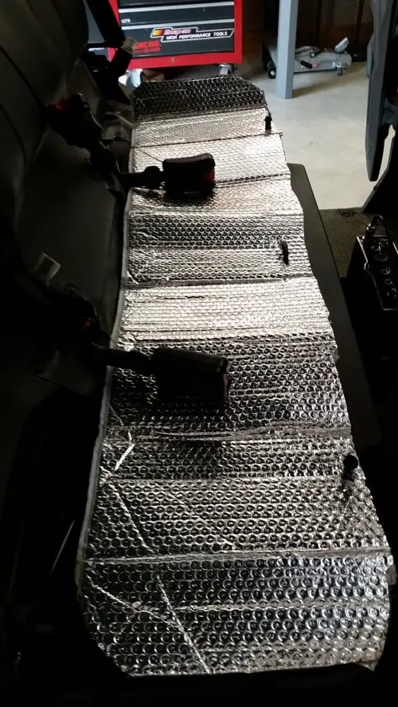

I'm not sure how well that shield will work unless it's sealed to the frame around the perimeter of the seat. I put some foam around the perimeter last night actually as well but have not tried it yet. I think the seat itself works as a heat shield, but the warm air comes from around the outside of the seat. I am also putting spacers on my half windshield to allow some air to come in underneath the windshield to help with the vacuum.
Dasmoeturhead
Well I reckon it's got to stop some heat/air, so what the heck.

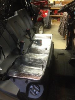

Tested the heat shield today while I was using my plow like a grader. Heat under the seat is down, but heat is really coming out of the shift lever cutout. I've got to try and solve that. It's nice in the winter, but not now.
Reactions: Hawk53
42,062
322,675
it would be nice to use Velcro around the edges of the shield and engine bay cutout but staple it to the shield for durability to give a more permanent solution as ease of take off in winter and fluid changes. As for the shift levers hard bristles like a door sweep on each side under the dash with two indiscreet plastic pop rivets on both sides, might be able to move the rubber shield that's already in place up and do same thing or a shield across to keep radiator flow to travel down under the vehicle. Or the easy way leave to hood off but that's unacceptable around people
