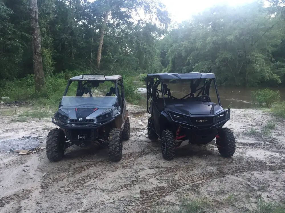

Now it seems my buddy with the can am is in fact coming home
IMG 1146
