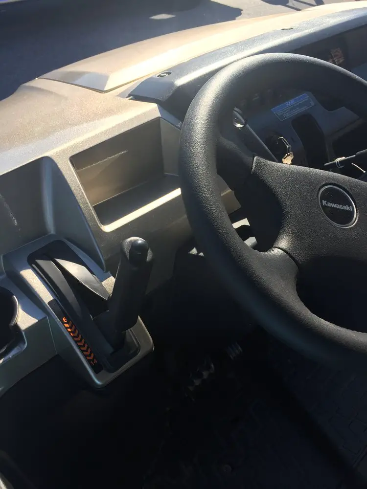

IMG 5542
Dropping it off at the dealer for service and looking at the Kawasaki 6 seater
diesel and what's the first thing I see? A gigantic emergency brake handle right next to the steering wheel!!!! SMH at Honda!
And I'm falling in love with their seating because it's a six seater versus five and rear seat pushes forward and the cargo bed extends to the same size if not larger than the Honda alleviating the problem of gravel and dirt falling down in between seat because it's a solid surface.
It's actually the absolute perfect solution to choose between seating or bed capacity.
DONT HATE ME FOR SAYING NICE THINGS ABOUT THE COMPETITION

View attachment 47533 Dropping it off at the dealer for service and looking at the Kawasaki 6 seater
Keep in mind about the Mule Pro is that it is bigger, slower, heavier, longer, and doesn't have a locking front Diff.
But it is quieter, cooler, has a bigger bed, and a very durable CVT and a 3 year warranty from the factory.
My local dealer sells Kawi and the Mule Pro is his biggest seller by far but I live in a relatively flat to rolling area with lots of farmers. They love them. Every time I drive by there is someone loading up a new one on a trailer.
Drove the diesel but it's ridiculously slow, like 25 miles an hour max! They should know better. The gas does 45 and is very smooth and already comes with a warn 4000 pound winch!
That's horrible if you can't lock the diff!!! But are you sure about no front locking dif? Maybe different on a 2017?
I just naturally assumed it had one without asking the salesman because this had 2 buttons and one was 2 or 4 wheel drive and other was lock / unlock.
I can't imagine what lock or unlock would be for other than locking dif.
