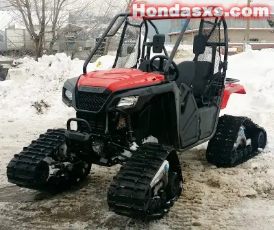

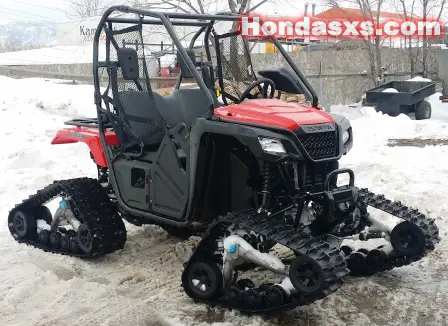

Here you go... The First P5 on tracks!
Don't have any info on it.. Yet...
All I know is I would love to take it for a spin.

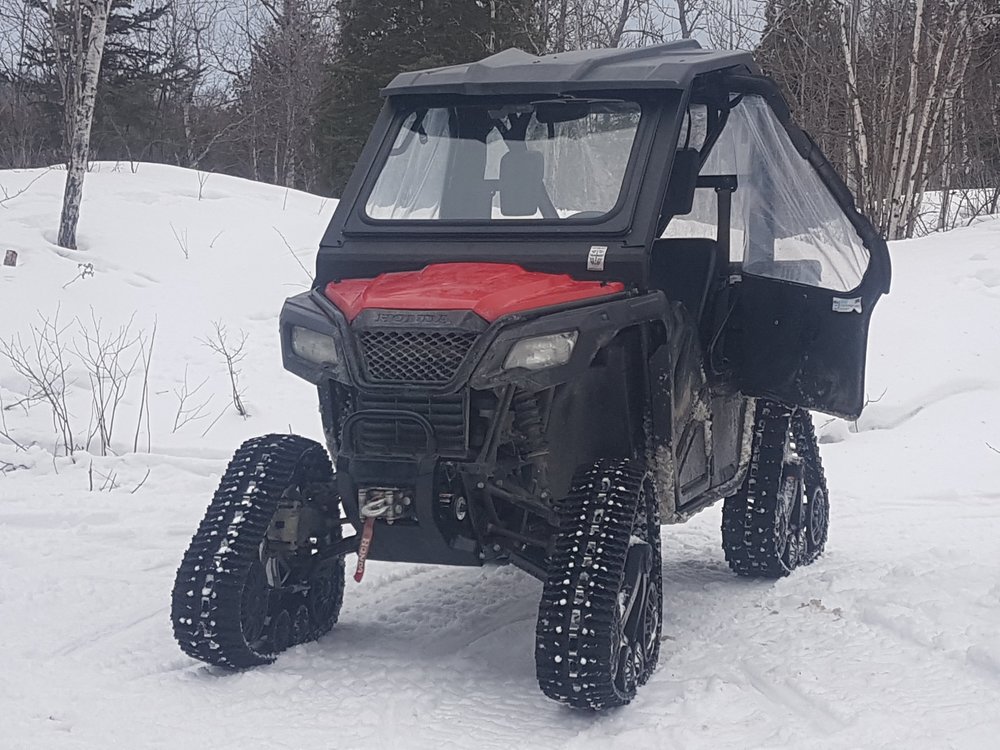

Winter atv tracks on my pioneer 500. Had to be modified to fit.

How do these tracks work if the trail intermittently turns to mud and dirt/rock here and there? Is continuous snow an absolute requirement or will there be damage to the tracks??

Tracks will typically handle anything but the wear life depends on the surface they are in contact with. I wouldn’t want to run tracks full time, instead of one bearing assembly you would have 5 to 8 to worry about.

Looks good. I like the ground clearance. How is it handling in the snow? Pros/Cons?
Its excellent in the snow, great floatation. Just don’t compare it to a snowmobile for speed and agility. Steering is pretty hard, a very harsh ride on anything hard packed. It pulls like a mule! I will likely order the soft doors cuz you get buried inside the cab with snow that is flung up from the tracks. The motor area, entire front end etc gets blasted with snow. Some of it melts and forms ice blocks. So, its very capable at slower speeds but you have to put up with some inconveniences and take 20 minutes after riding in anything more than 4 inches of snow to do a lot of cleaning before parking it. Unless you always keep it in a warm place. (I brought it into the shop to melt and dry out...ended up with a frozen gas line as a result. Keep gas line antifreeze withyou!)

The Kimpex Tracks that I use are very tough and made for all year conditions like mud, rocks, bush trails and sand etc. They don’t need lubrication like snowmobile sliders. I bought the Kimpex because you can replace individual bearings if needed.

The Kimpex WSS4 Tracks that I use are very tough and made for all year conditions like mud, rocks, bush trails and sand etc. They don’t need lubrication like snowmobile sliders. I bought the Kimpex because you can replace individual bearings if needed and with proper adjustment, they dont rub on the frame in the front thus allowing full range of steering. Most other brands come with a steering limiter kit, not needed. I also bought a cheap tractor type steering knob...definitely helps the steering. [ /QUOTE]

I’m going to attempt making some sort of fender flares that come out as far as the tracks...this would direct most of the snow spray down from the cab. Looking for ideas as to some sort of flexible but ridged plastic rated for cold Canadian winters!
