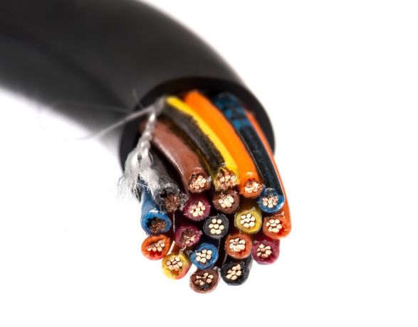

I would think you would be perfectly fine to daisy chain all the switch wires together. They won't be high current since they are only used to trigger the relay, which will handle the higher current loads. That is essentially what I plan on doing for my other bank of auxiliary switches. For simplicity sake, I will be purchasing, probably 12-16 conductor, tray cable for this purpose. It'll be 12-16 (depends on what I can find) small gauge (probably 22-26awg) wires packed into one cable that will only be used for the switch loads. I think it'll drastically cut down on the wire clutter.
Something like this:
Tray cable
Bigtee

That's a good idea, I'll look for one with 8 to 12 wires.
