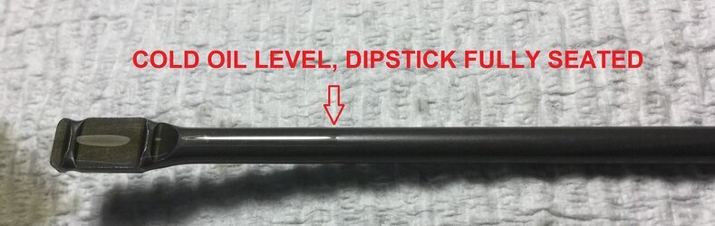

Right after an oil change, running long enough to saturate filters and letting sit -
So iff'n a guy was real lazy, he might ask you to get out your calipers and measure from the bottom of the dipstick up to your cold oil level mark, then just mark his own at the same length, right? 😆
I like it. He's posted that on this site probably 12 times. A measurement would be helpful

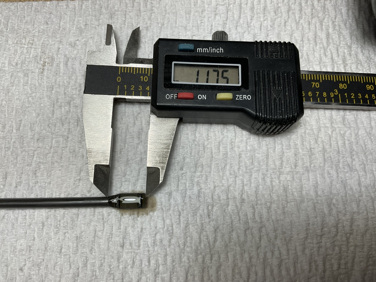

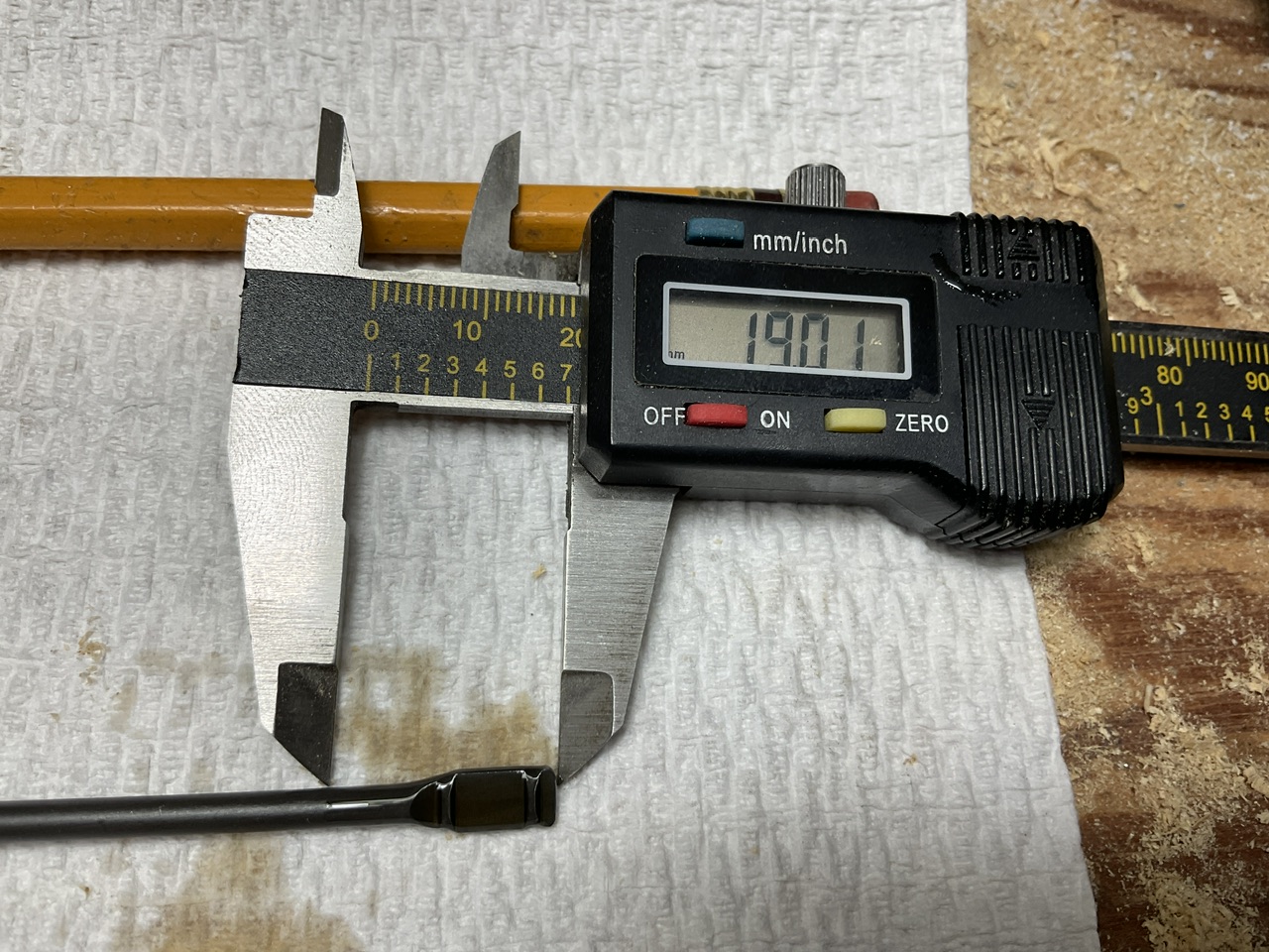

But since I changed my oil yesterday, warmed it up and loaded it today and it's been sitting on the level trailer for hours, here ya go. Note that the pic looks different than the one I posted above, the only difference that I can think of is that I made sure to level the trailer tonight. Instead of using my numbers, you should do your own next oil change.
Details - oil and both filters. Spec is 6.1 qt. which is 6 qts. 3.2 oz. for my Talon. I rounded up to 6 qts. 3.5 oz.
Not screwed in, sitting up on the threads - (mm)
IMG 0647
Screwed in all the way -
IMG 0648
