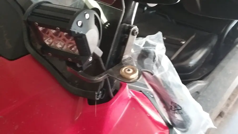

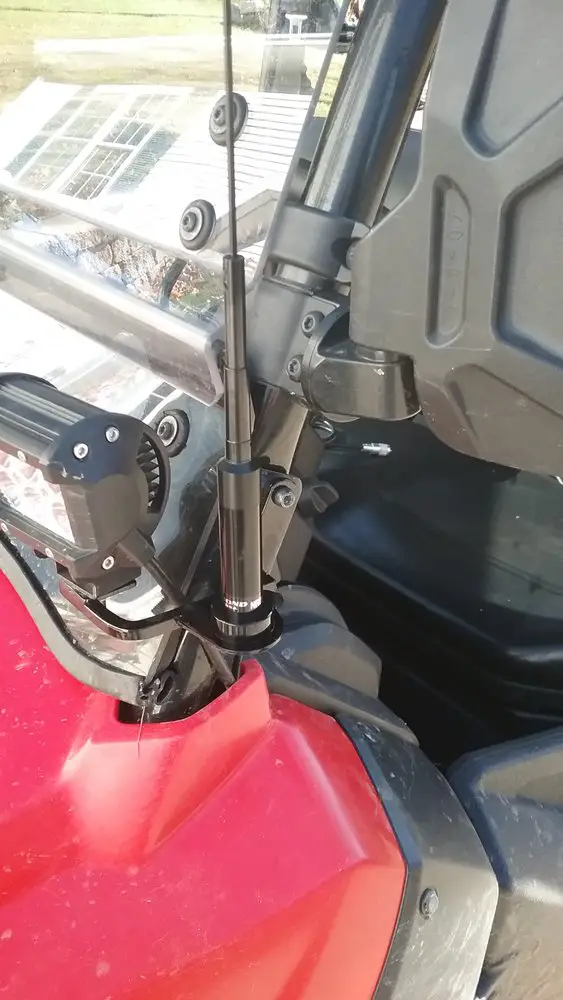

i finally ditched my mag mount antenna, I had mine mount in back up high and got sick of it getting beat up by branches. I have the same antenna on my truck (uhf mounted) so I know they work good so I bought a nmo mount of the same antenna (https://www.amazon.com/NR770HBNMO-Mobile-antenna-70cm-40in/dp/B00AR09XBK/?tag=sxsweb24-20) to put on the pioneer. I already had made the mount for the led cube so I just made a tab to put the nmo mount on. View attachment 90840 View attachment 90841
I like that , very nicely done.

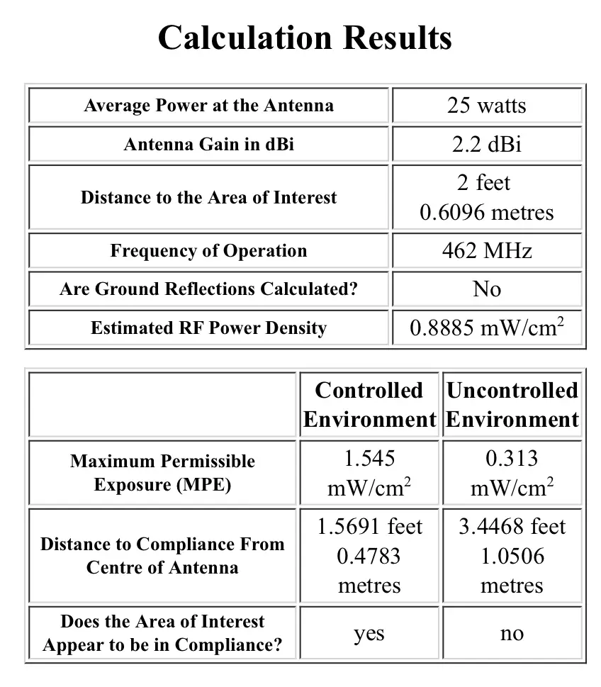

RF emissions near head? Fender mount or at least move a bit away. Depends on wattage output. Seen some 25-50 watt output units mentioned. Maybe some of the more experienced members know more, I’m new to the ham hobby.
Enter parameters - Power Density Calculator - VP9KF/Hintlink

Just punched in some numbers as an example. Maybe others can punch in more more accurate values, like I said, still new, so no warranty on results, LOL.

From a careeer in Radiation Protection/Health Physics, the ole, Time, Distance or Shielding concepts are stuck in my mind. Even for non ionizing RF, would not recommend significant wattage output next to the body of a friend. Just something to consider with antenna placement for higher wattage mobile radios.
32,051
Not saying you’re wrong but TIME and maximum allowable distance may be the ticket.
If it’s short burst on rare occasion may be significantly less to worry about.

Spot on @ohanacreek , we used the ALARA concept, As Low As Reasonable Achievable, for the conditions. Hazard may not always be eliminated, but minimized if practical. You’re ready for a job in Nuclear Power, LOL.
