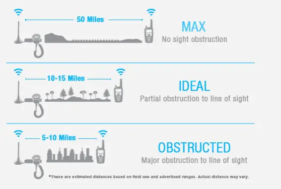

All that said if you are riding in a group of 7-8 machines spread out over less than a mile you will probably be fine with a handheld, a mobile or installed unit make it nice to not worry about recharging every trip and can give you a little extra power if needed... just know the radio freq these broadcast on are line of sight so if you are at the bottom of a hill in a gully your not talking to the bottom of hill in another gully. Wattage of the receiving radio plays no factor in how well or how far away you can hear another transmitting radio - Antennas however play a huge role... and like everything.... everything is a compromise with regard to antennas.
Graphic I stole from Midland radios (note the mileage is probably not real world results) but it gives you an idea of what affects transmission range
Upload 2018 10 23 9 46 46
