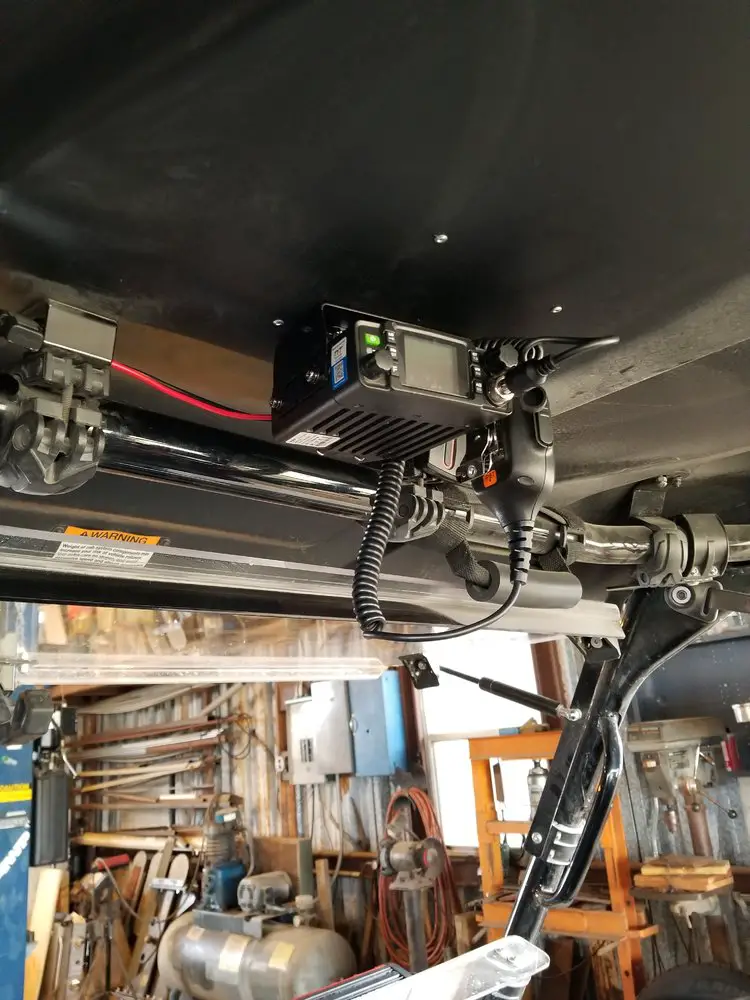

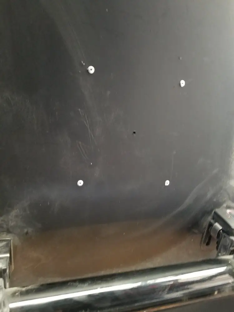

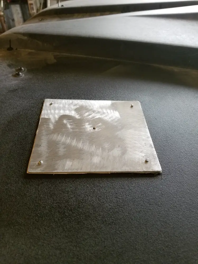

Here's my install.
5x5 16 ga. aluminum backing plate on top. Applied a layer of elastomeric tape between the top and plate. Going to spray the plate with Flexseal type material after completed. 20180205 125224 20180205 120934 20180205 120926

The rivits will keep the plate in place. The radio bracket is through bolted wih 3 #10 screws and star locking nuts

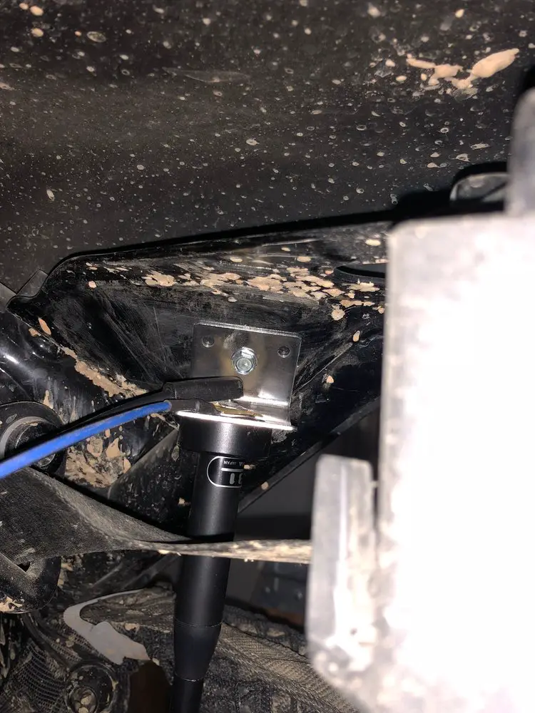

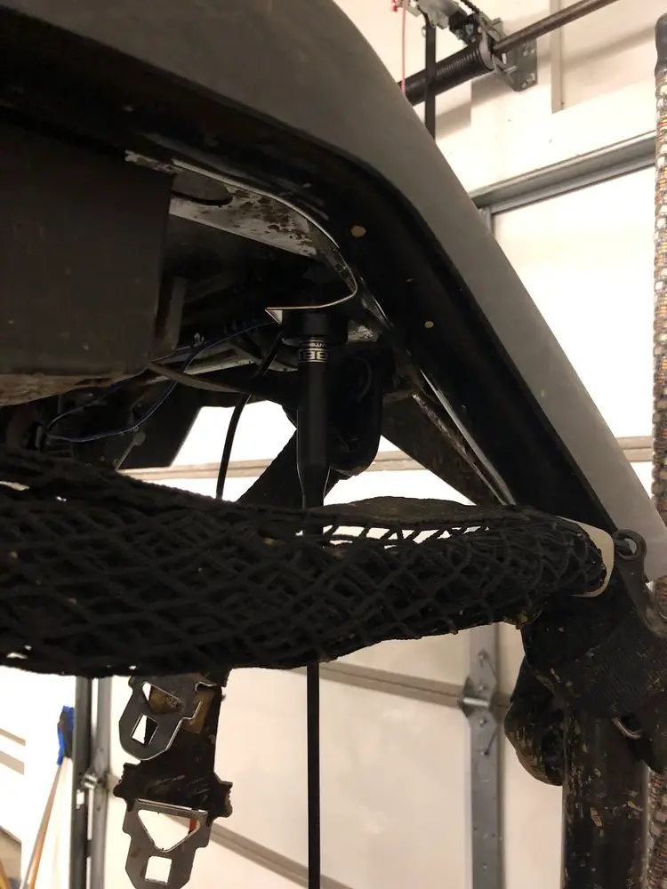

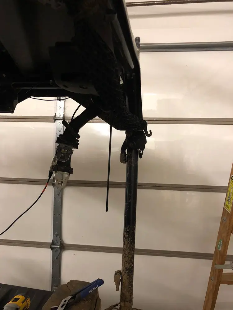

I took @Windrock1000 temp antenna placement as inspiration and believe I have my antenna where I want it now. I am hanging it upside down just inside the rear drivers side. The antenna I am using is a comet SSB1nmo - it is more expensive than the amazon prime version but it is also flexiable which I think can be a +. Will if function better? After installing I put the measured the SWR and was running 1.4:1 over VHF and a little better on UHF so I am happy with that. Antenna is just installed so I will clean up the wiring before installing the radio this week.
30FE5EAA D216 42B3 9741 7A685751933C
CD98A712 5ECA 468D AB91 6AB9B9AD0448
479273B8 A981 4EFE 94DC 6459259CBCA2
Also @Windrock1000 my radio is not displaying Chinese - I am still unable to find the setting for you to change but looking.

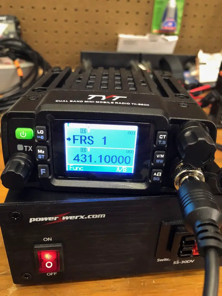

Here’s the image file I pulled from my radio.
It’s for a B-Tech 25x4
Dropbox - BTECH_UV-25X2_20180205.img
It has all the FRS/GMRS/MURS/NOAA channels.
Along with my presets.
Honda 1-4 is open channel
1-2 being VHF 3-4 being UHF
HONDA A-D is sqlTone so only radios with those channels preset will open the squelch on the radio.
A-B VHF, C-D UHF
101 up are the repeaters within 20miles of Lafollette, TN
ignore 70-99 those are local repeaters.
BUT You can download your radios program into the Chirp program.
Then open this file and copy all the channels over to your radio image file and then upload that edited file back to your radio.
