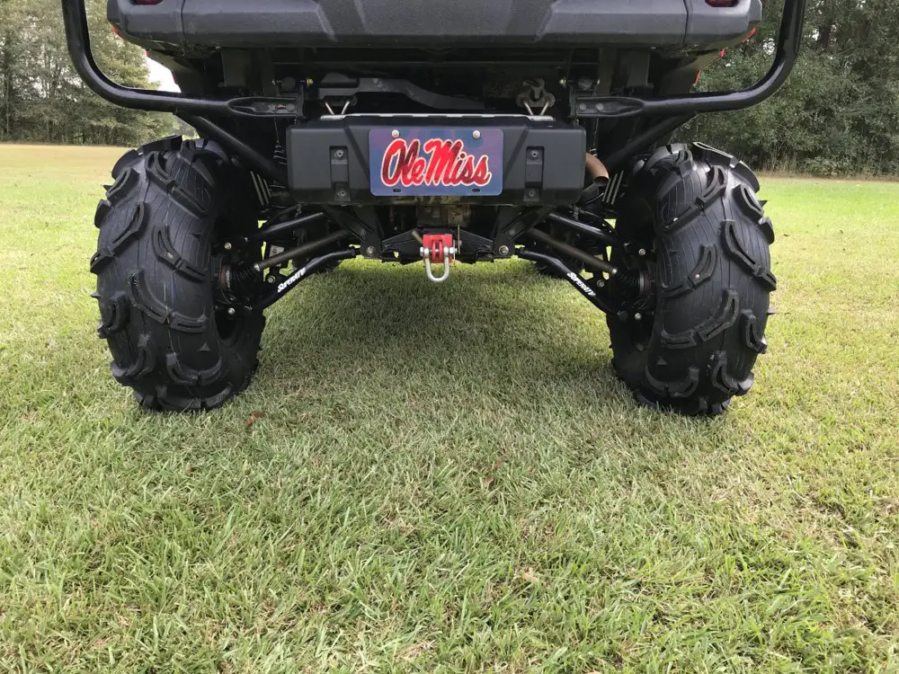

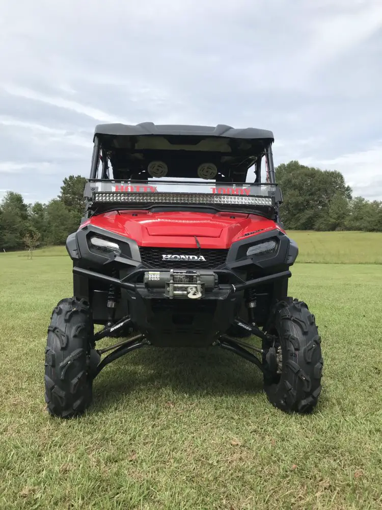

Nice ride! Did you also need axles? Or do the stock work? I'm looking into the exact same set up. ThanksI’m running SATV 3” lift along with SATV
Forward and rear A arms . 1 1/2 wheel spacers up front and 2” in the rear
Combined with 30” Zilla’s . Runs great !
As soon as the gear reduction comes in
I will have it installed and move up to 32” tires . I have to hand it to SATV everything fit with no modifications. View attachment 163883View attachment 163882 View attachment 163881
I think it’s recommended but I’m not sure? When I had a lift with stock arms I did not. I no longer have the lift and just have STAV arms and still have standard length axelsNice ride! Did you also need axles? Or do the stock work? I'm looking into the exact same set up. Thanks
Super atv recommends upgrading the axles if your running the super atv foward A arms and lift combined. I returned my 3" lift and just went with the arms from super atv and 30" intimidators. I think you'll need the axles if you run both combined.Nice ride! Did you also need axles? Or do the stock work? I'm looking into the exact same set up. Thanks
