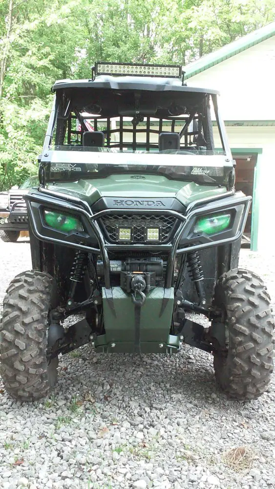

25,113
185,560
I mounted my 22" right to the plastic roof with the hardware supplied. It has came loose once and was hanging from one bolt.
Not the ones through the roof though, the ones that screw into the bar. It does take a beatin' up there.Front Latest
Reactions: Jshell3 and rocmar
Not the ones through the roof though, the ones that screw into the bar. It does take a beatin' up there.View attachment 23203
