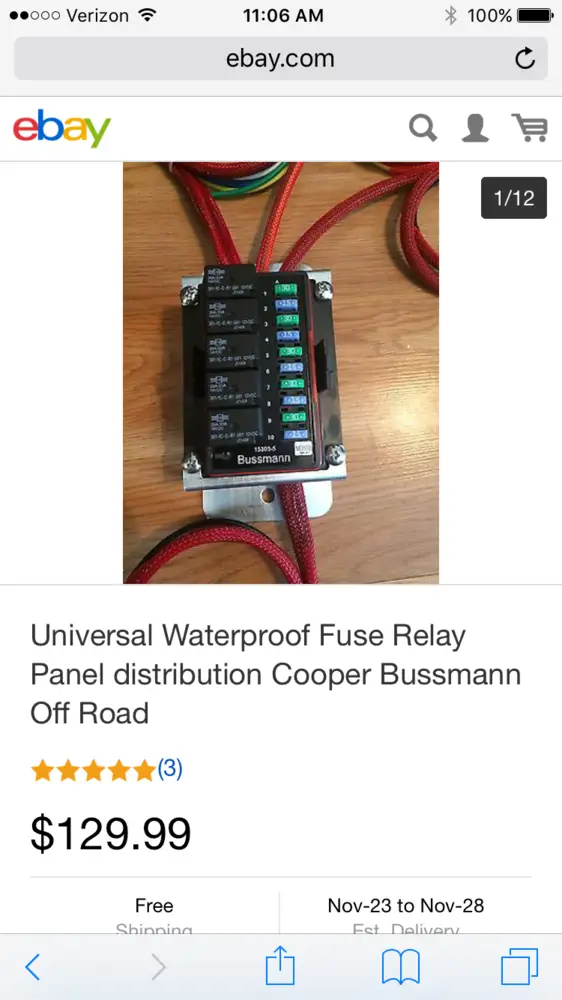

I actually just got a prewired Bussmann today in the mail so I have all the fuses and relays in a waterproof container wired and ready to go! Main concern was what to do with the negative wires.
technically, you only have to run a hot wire from the switch to the accessory, and then ground the accessory on its bracket or to the chasis nearby. most of my accessories have a ground wire running to a bus under the hood, but my stereo is in the very back, and I only ran a hot wire to it... its grounded to one of the old net mounts up on top of the ROPS near the back.

Don't mind admitting that I am a bit intimidated with the next phase of my project - electrical!
I know what I want to do and have purchased the Bussmann fuse/relay panel recommended by @JACKAL and it is very nice. I believe I'm going to mount it where the second battery was (moved it under the drivers seat). I also have one of the very nice switch panels provided by @mystic1219.
Not considering anything real sophisticated, thinking about powering and switching the following all separately: winch, 20" light bar on the bumper, two 2" POD's on the front, two 2" POD's on the rear, front interior light, rear interior light, volt meter, USB charge plug.
The panel mystic1219 supplied has cutouts for ten switches, two round holes and a 4 bolt Ram mount. I will be attaching my Garmin Zumo off the Ram mount, but it will be wired to the ignition through a fuse.
I need to select a switch brand and start making those purchases. Looks like good ole Amazon has me covered in that area. Been looking at lights, but have yet to make any purchases. I want to have everything I think I'm going to need on hand before starting.
