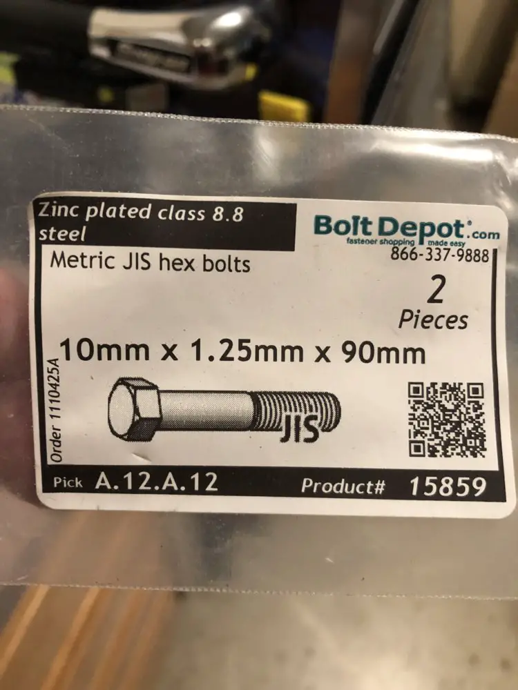

Order these (unless you can find them locally) then you can bolt both the bumper and receiver hitch together...
9RkE7vnuTAG9hSKIDLq3A

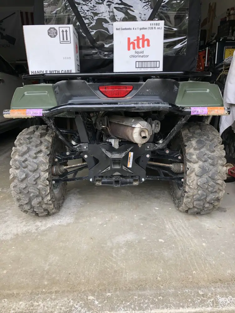

Here is mine after I figured out which bolts I needed.
0J8hlEAAQCSwrsvmXgYDnA

@ToddH , that moved your bumper back some didn't it? How much?
It only moved it back the width of the 2” receiver (maybe a 1/4” or so). The top mounted like normal. Only needed the longer bolts to go through the frame and 2” hitch.
