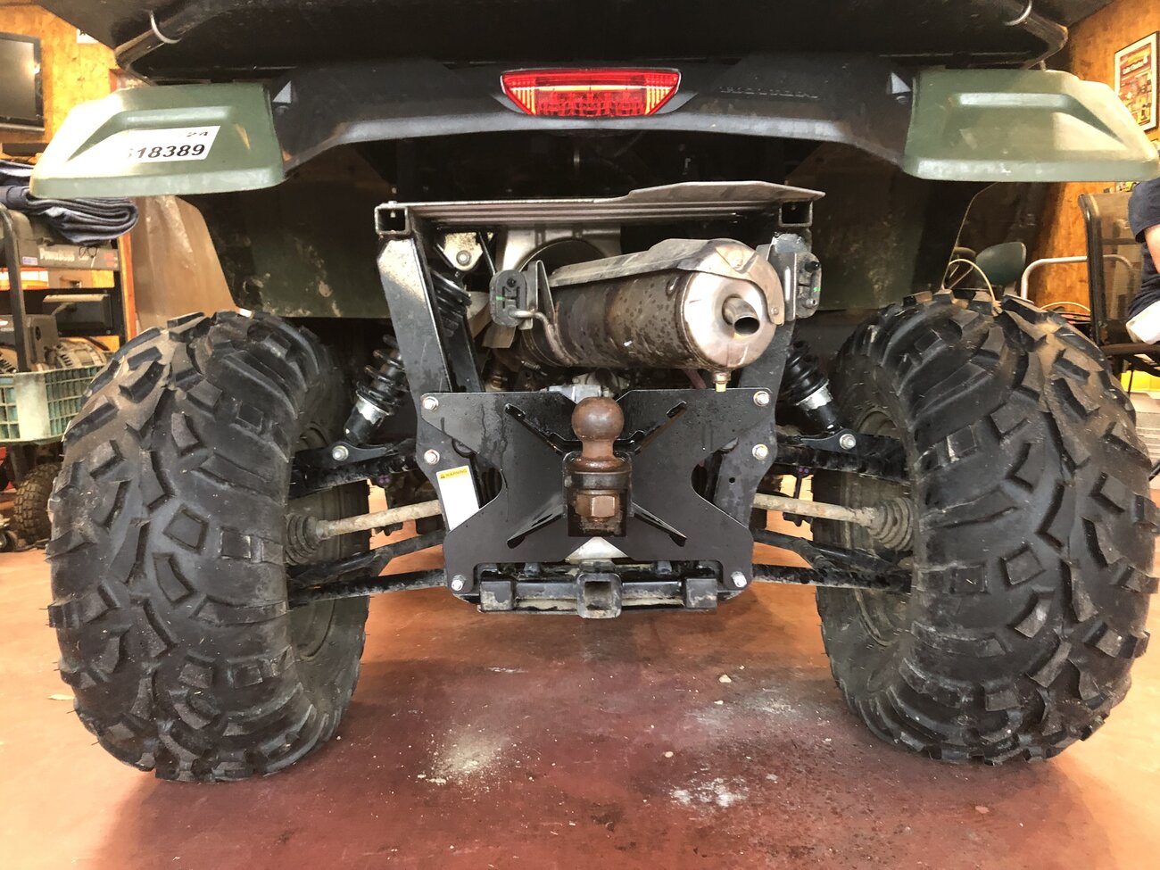

I finally ordered the Moose 2" hitch receiver (Partzilla) for my 2020. It went on without any mods/adjustments! :) I need to clean up hitch and put a little paint on it and put it to use!
Excellent! Still on my list to order, it seems to be out of stock everywhere currently... Just like everything!
Looks good.
How much clearance do you have between the top of the ball and the muffler? Enough to put the receiver hitch on I must assume.
