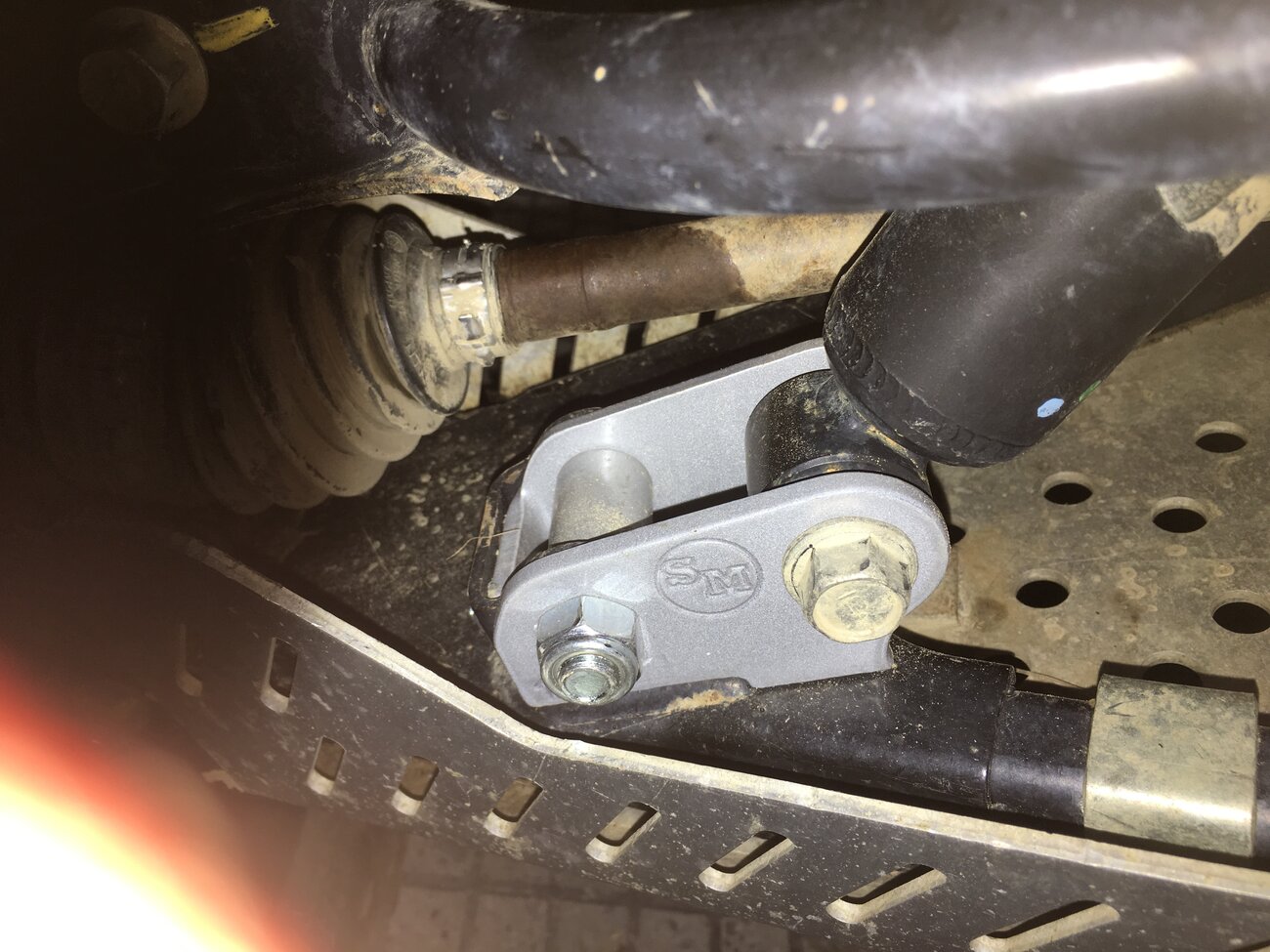

I had the 2"strong made bracket lift on my 700. It was very well built. The newer models (I think 2017 and up) are just spring spacers and they definitely make the springs stiffer. I do not recommend the strongmade bracket lift. I know some people love it but my tires rubbed worse with it than with no lift.
A 2” lift is as big as you can go. If you Jack the sxs up with a 3 inch lift you can here the axle popping and binding but with a 2” like this one from strong made it does not.Very simple to install. I will note that super ATV did not have the arched arms till recently or I may have went that route.

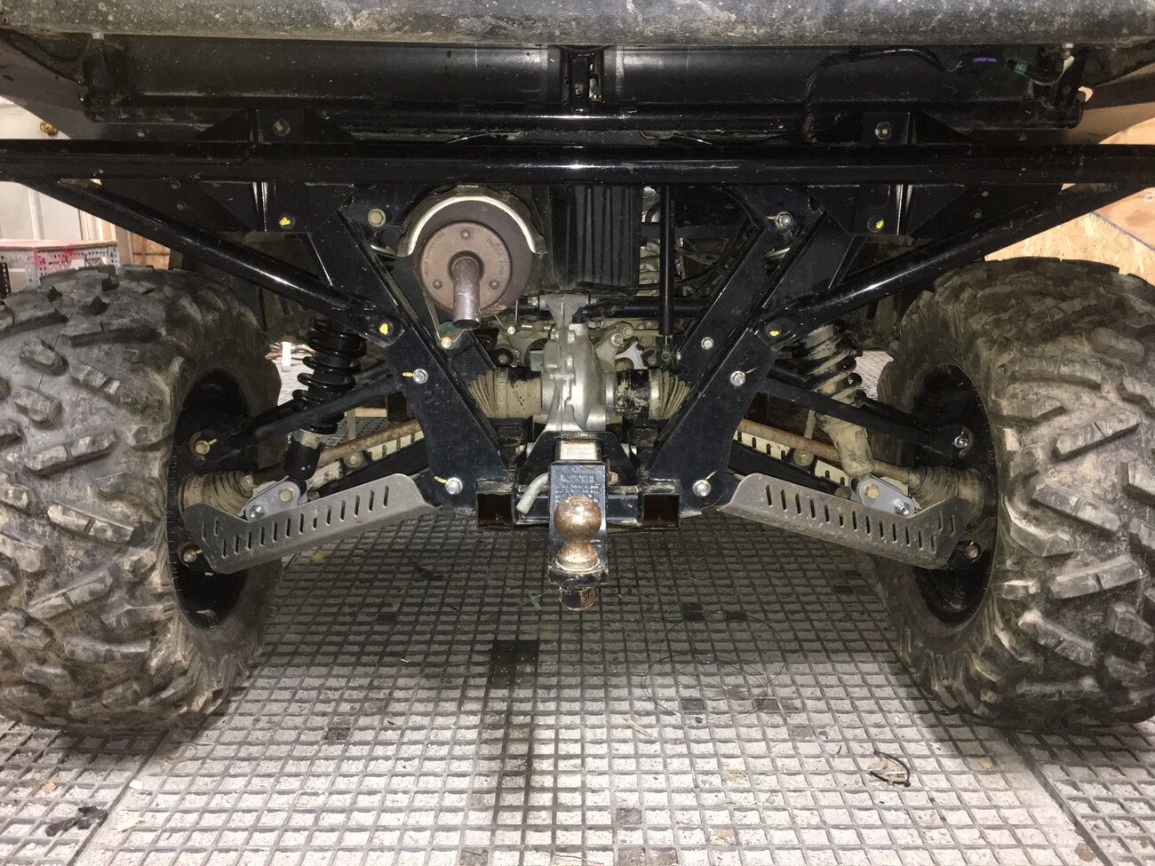

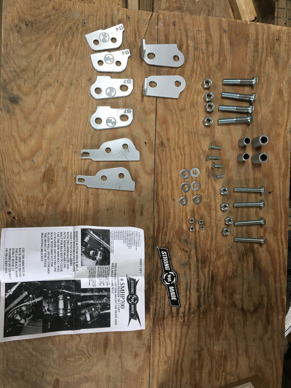

A 2” lift is as big as you can go. If you Jack the sxs up with a 3 inch lift you can here the axle popping and binding but with a 2” like this one from super ATV it does not.Bery simple to install. I will note that super ATV did not have the arched arms till recently or I may have went that route.
View attachment 320043 View attachment 320044 View attachment 320045
That's the strong made lift. I didn't have good luck with it. It acted like a lowering kit for me. Glad it works for you though. I went through a lot of trial and error(mostly error) when I was trying to figure all that out. The super ATV lift mounted to the top of the shocks.
Man!!!! You are right. I could have sworn I ordered all my stuff from them in 2014. I have got to look at the pics before posting🤦🏻
