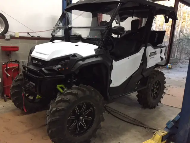

My thoughts on the IGR.
Specs
With my 32s it would only run 46mph
Info
It had all the gear I wanted before but you can feel the difference.
One thing you will need to know is after it want shift right at first it will stay in a gear if you give it to much gas and hit the rev.
You will need to give it gas then let off to shift till the computer relearns. To me it seemed to learn faster when I used Manual mode.
I didn't really do it for the gear I did it to save the clutches.
Update (the IGR is a little loud it doesn't bother me but it does my wife)

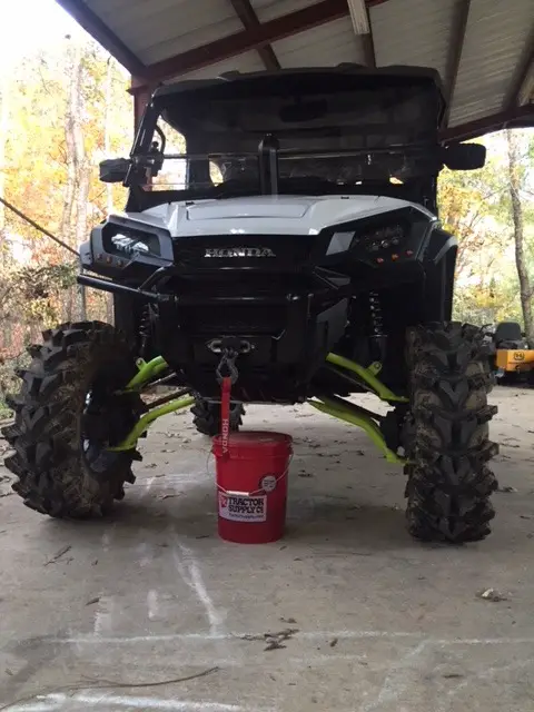

Took the SXS out for the first time. lets just say WOW its a beast. I have a 420 IRS on 31 outlaws and would have trouble in a hole and the pioneer would make it in turf mode. I only needed 2wd a few times and 4wd twice the pioneer is just a different level. Never got stuck got on a stump once but could still back out.
If you look close at the pics you can see I had it waist to chest high in mud a few times. The wife just got the tires in the mud but I needed to know what it could do so I tried it out.
You can see the mud lines on these.

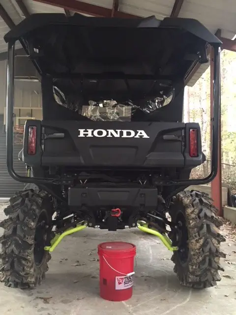

Snorkeled my exhaust have it clamped on but will end up welding it just what to make sure I like it and am happy with it. Or I may just use exhaust tape. Worked great first trip out. I needed to make it come a little more over so I could lift the back all the way up but its close enough for me. The last pic you will see the exhaust hanger I cut the material and used it between the exhaust and cage rail. Local exhaust guy bent the pipe for me same one that did the 420s. May build a Stainless tip and snorkel down the road I think that would look sick. Also keep in mind the pipe is a little bigger that the tip so I shouldn't have any restriction.
