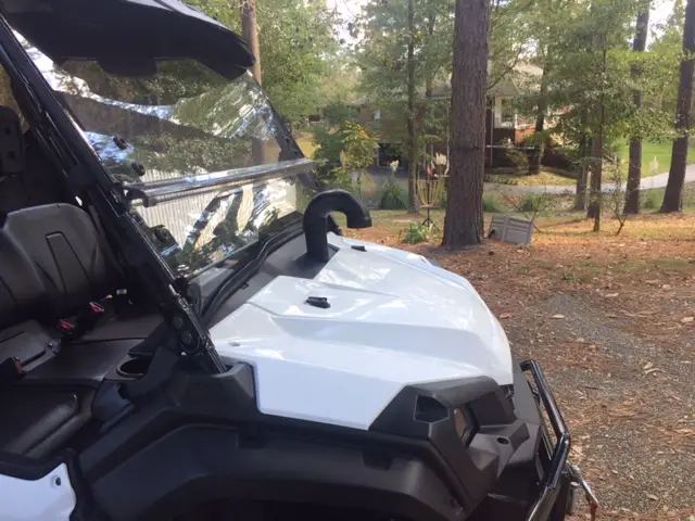

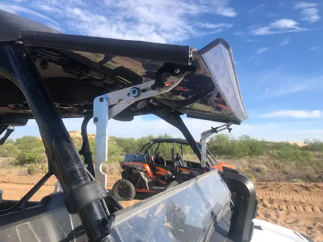

First off I'm sill loving my Alien Shade roof and with my hard top on can see a big difference in temp as it acts like a barrier for the heat off the hard roof.
I added tent to my top piece of my windshield very happy with it. Did it myself for $30 if it doesn't hold up I can live with that did it a week back so far so good.
Also added two piece windshield extenders really like them.

Does the extenders only give u fully open and fully closed options? Aslo does it hold steady when fully opened while riding the trails? I have a friend that needs something like this for his machine.
100% adjustable from 0% to wide open. I ride down the road with them open like you see in the pic pulling it with my truck at like 65mph and it holds very steady more then the stock style did but it maybe because less wind is hitting it head on. But I would say they are very stable. I did trim maybe 1/2in max off the corners of my hard top to make it so I can extend it all the way up if I want.
Good deal. He was getting ready to take his windshield off because of the heat. This will fix him up.

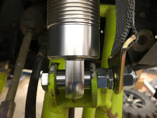

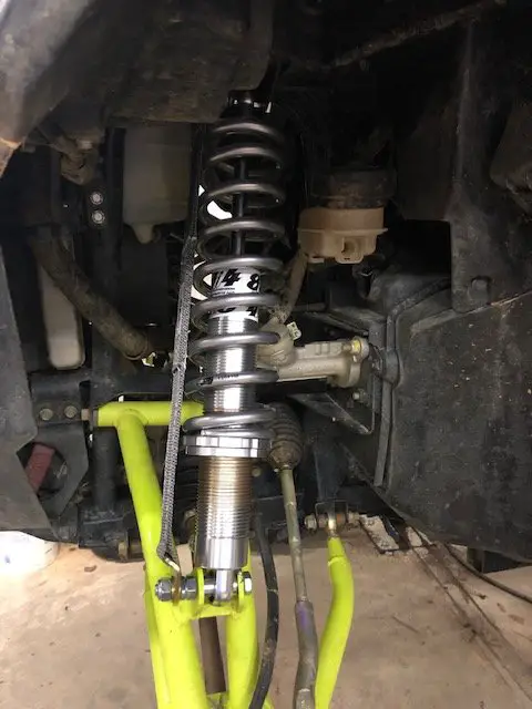

  2. Talon X4 LV
Clearance before 17 3/4 after 18in so after settle I would say no extra clearance but you could by tuning the spring tension up.

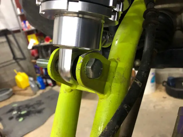

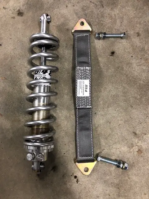

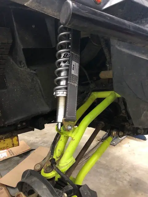

Added the 814s shocks took them to the takeover for my first ride on them. (They worked way better then stock but I'm still adjusting them so will give a full review at a later date)
I set them at 18 1/2 bolt to bolt (This has to be done with all wight of the sis on the shocks)
(Then 7 rebound and 3 compression)
First off if you don't have a lift this is a job. I had a lift and it was still a job. (Adding shocks is easy setting them is the hard part)
Had to grind a little off the C-fab shock mounts you can see in pics.
View attachment 127924 View attachment 127925 View attachment 127926 View attachment 127927 View attachment 127928 View attachment 127929
have to know how you like the 814 shocks? my 1000-5 is setup a lot like yours and wanted to keep the rear end down on thr rougher trails
Its night and day better. When I add 200lb to the back its still a little soft and will rub just a little on hard bumps. I could/need to adjust a little but I alway forget. For the money I'm very happy. If the Sxs was my main toy and had the money I would have got the foxes for simplicity but it may would have rubbed and I couldn't adjust so its hard to say if they would be better. What I can tell you is they do the trick and I'm still happy with them.

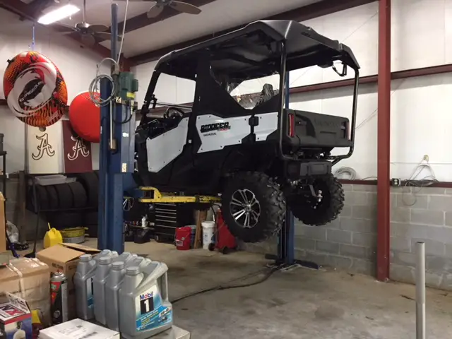

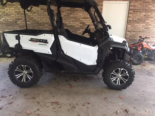

When I was looking for info about tires fitting I didn't find much info on the bigger size tires. Thats why the name to help others find info. Bought this for my wife and kids for the most part. I have a a 09 Rancher IRS on 30in zillas. Me and the wife stoped riding after kids now they are older 5 and 8 so its time to get back into it. I'm sure many will know most of my info but hope this helps.
2016 Honda Pioneer 1000-5 deluxe 53hours 403 miles
Clearance stock was 13 1/2in high. Measuring from the bolt under the door.

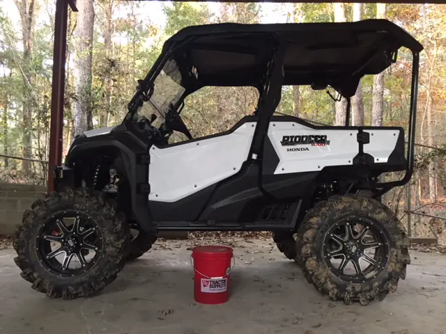

First the info you need to know Honda wheels are 4/136 lugs are 12mm with 1.5 studs. But most 4/137 will fit. The wheels I got have a 5-2 offset.

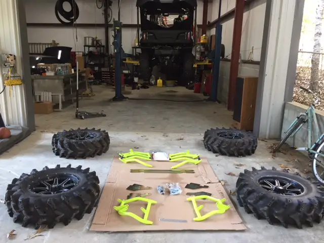

First I found a set of 34in outbacks on 17in wheels (Everything I could find online said they wouldn't fit without portals but I had to try and knew I could trade for a set of 32in or 31in easily.)

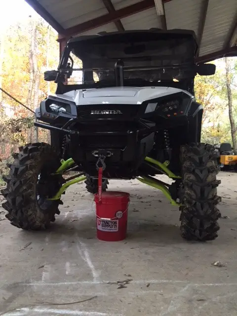

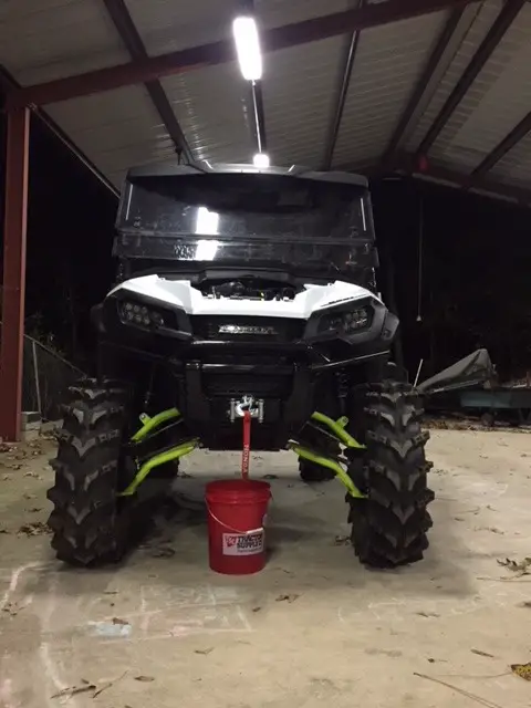

I decided to go with C-fabs lift/a-arms they are about 2 hours down the road. They claim to give 3in of lift and you can go 32in tires with the kit. (Yes I would buy this kit again)
Honda Pioneer Forward A-arm Kit | CFab
My review on them.
P1000 - C-Fab lift Review.
Being I pickup the 34in tires I ordered the high lifter 2.5in lift also. (Only problem with this lift is I had to take off the radiator heat shield the new one that came out in 2017 not a big deal)
High Lifter 2.5 Inch Lift Kit for Honda Pioneer 1000: SideBySideStuff.com
With the a-arms on and the 2.5in HL lift and 34in tires it had 20 3/4in clearance.
Just like I was told it rubbed I took a heat gun and a softball and tried to push the floor pan back to get it to quit but it still rubbed. So I ordered 2in wheel spacers. With normal driving it didn't rub but as soon as I put it on some terrain it rubbed and it rubbed bad. So I gave up on the 34in tires and traded for some 32in Outbacks on the same wheels. Fixed all my problems.
Side Note.
34in Outbacks road rough till about 8-12mph then smooth as glass.
32in Outbacks road smooth all the time.
19 1/4in Clearance with 32in outbacks, C-fab a-arms/lift, 2.5in HL lift.
Pics on 32in Outbacks
View attachment 59815 View attachment 59816 View attachment 59817
With just the C-Fab arms with the 3in built-in lift and 32s. (((( It stands 17 3/4 tall at bolt in middle of front door. )))) This is after I took the 2.5 Highlighter lift off.
