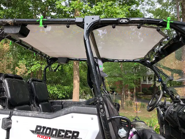

Added the Alien sunshade. The hard top held heat and made the dust come in real bad the top works great.
Update on top this thing is sweet worth the money.

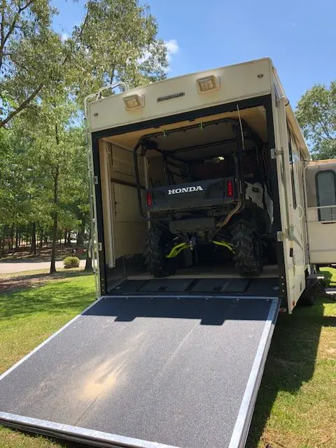

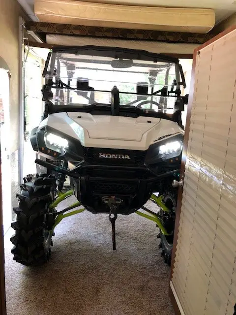

Been working on getting the 1000 to fit in the camper may end up having to take the 2.5 HL lift off and just have the 3in thats but into the A-arms. Its hitting my beds.

Still loving the Alien Sunshade didn't even put the hard top on in the winter but I do live in MS.

No worries I was just seeing what the side-by-side measured from the ground up probably the back of the buggy because that’s the highest point I was trying to see if I can lift mine like yours but don’t know if it’s going to fit in my trailer
Want be home for a few week but will get you that info when I get home.
Bradley-Thornton
Bradley-Thornton
Nov 6, 2017
684
1,650
Hattiesburg MS
79 3/4in in the back Front was lower
That is with C-Fab A-arms (3in lift built in to the arms)
32in Outbacks
Alien Sunshade mesh roof (no hard roof) Honda Pioneer metal pipe is the highest point.
