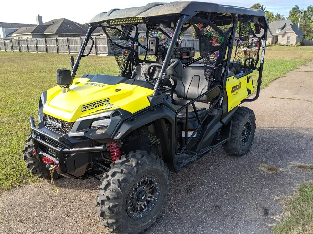

Looks good! What year? How deep are you going to need the snorkel?
Thanks! 2018 and snorkel is more of a precautionary measure. I've never taken it deeper than the bottom of the seat and even then it wasn't intentional. The ATV park near me has some nasty spots and sometimes the hole you went through a weekend ago that was 6" deep is now 3 feet deep.
