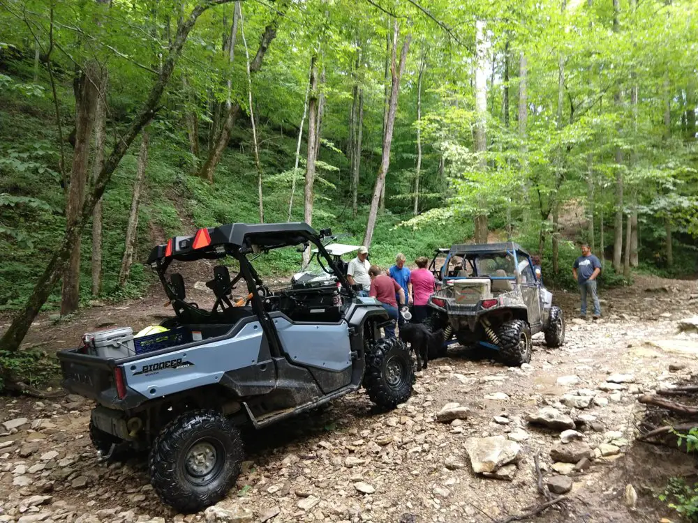

Ok I need some professional advice from a seasoned veteran, I am still green on this subject of fox shocks, I am getting ready to order a set of fox shocks and need to know do I or can I order shocks with the spring rate needed without ordering springs after the fact, if that be the case then given Your knowledge of the different springs if You where Me what would You order, I have a stock 10003 eps it is usually me and the wife and the dog Max, riding hard pack and rocky trails in Kentucky mostly some mud, I do not ride hard or fast and usually not much cargo just a small cooler and some tools in a milk crate , would appreciate any advice it at the very least would give me a good starting point,,,
I see you have the 3 seater and that does come with the lighter spring package. Like that color btw.
It was @Cuoutdoors that came up with the spring numbers on that one so maybe he’ll be of more assistance. My buddy accidentally bought Pioneer 1000-3 shocks for his 5-seat and I will say it was a better ride.
IMHO buy the shocks (it’s so much better ride) and see what you think. There are other ways to cushion the ride as well. Lower air pressure, taller tires and a big one is removable of the rear sway bar. But I’d feel it out and see what you think first. For most upgrades you loose something in another area so make damn sure it’s what’s needed for you.
