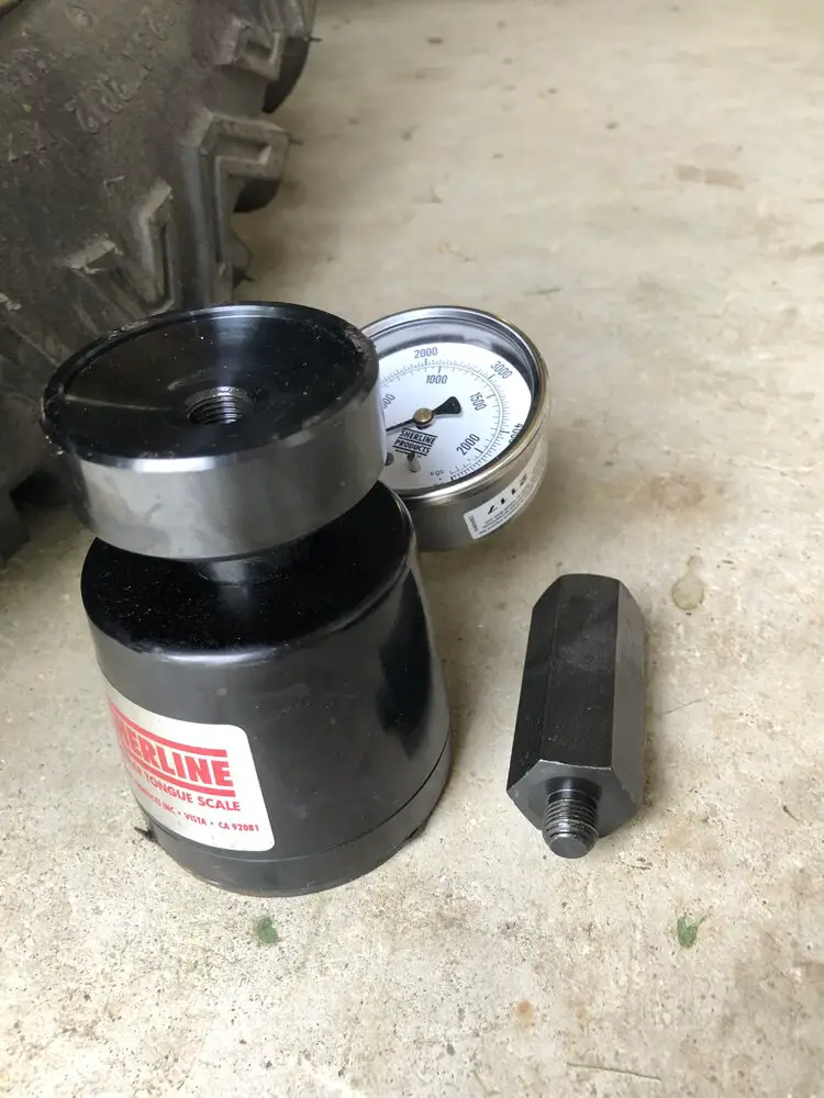

I am loading my box trailer to close to the tow limit of my Tow vehicle so I wanted to know what the tongue weight is.
I had seen a YouTube for a scale that fits on the tongue jack but when I googled it there was another scale that looked more useful.
Got a Sherline trailer tongue weight scale.
They come in several weight ranges, I got the 5,000 lb.

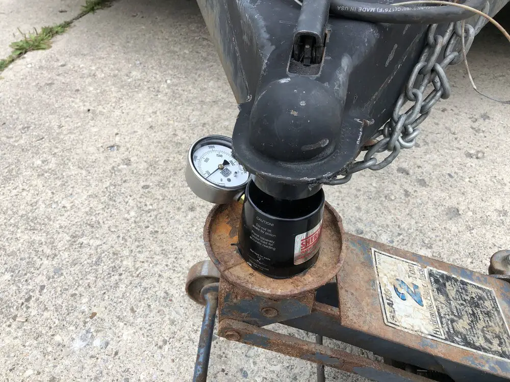

Scale sits on the floor jack and you jack up what you want to weigh.
I was able to weigh the whole trailer by lifting each side of the frame in front and behind the wheels (two axle), average the number for the weight center of the axles.
Add up both sides and the tongue for the total weight.
I have drop axles, with straight axles you could pick up each axle directly.
Once I had the total, put the scale under the coupler and roll the load around to get the optimum tongue weight.

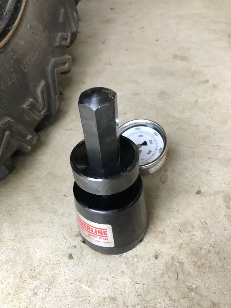

Scale comes with an extension to reach up in the the coupler.
2651AE75 F85E 4B5E B428 DF8CBF3D634A

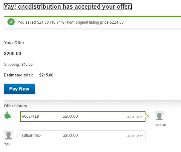

For sure, I literally just bought one. Guy has it setup for best offer and I offered $200. I'd try $175 and sneak up on whatever his auto accept threshold is if you're thinking of buying one.

Just an update - canceled the $175 offer and put in one at $225....wasn't auto-accepted either, but just said screw it and waited. Woke up this morning and showed offer was accepted. $240 total shipped is a lot better than $350! Thanks @CumminsPusher @Adam490
