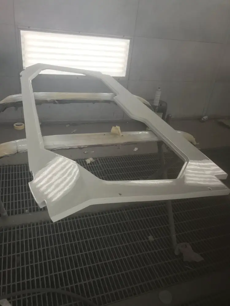

Router work done and found a couple nicks so sanded out and decided to lightly prime the whole thing. It's not a car so I cheated and used lacquer spray can. As long as it's not thick it usually doesn't shrink back too bad. Rounded edges a little (tried to keep everything crisp edges because the Pioneer has them.
IMG 7739
Gotta clean and spray. Again I'm using GM code WA8624. Two coats PPG single stage and a heavy coat of clearcoat will do great. I use single stage for solid colors because it's got great resistance to the elements and doesn't actually require clearcoat but I like clear.

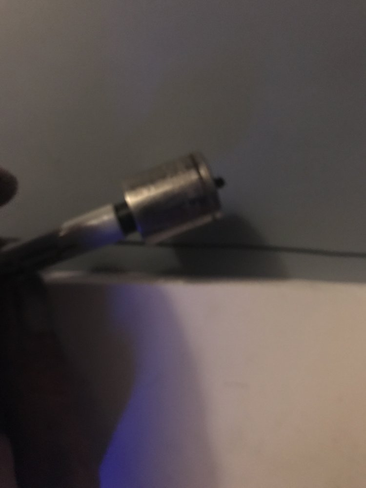

I wanted to share this because it may come in handy for someone on various things. If you need to trace a line but make it larger you find the right socket and place Sharpie through the center so it'll never allow the Sharpie closer then that space. When tracing the windows (because of the routered inset of 3/8 inch) I simply place a socket on and trace the cutout. Pretty simple trick.
