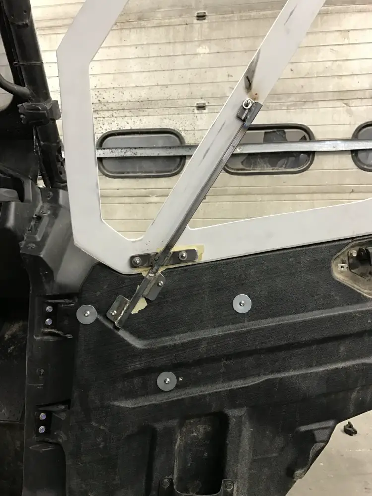

Ok got front mount designed its solid. Built a bracket to go on the inside to stablize the window frame. Everything is crude I know but it'll all clean up nicely and it's easier to show what was done with contrasting colors.

This is the bracket that goes into the door pretty simple. It shows how the two are sandwiched.

Ok got front mount designed its solid. Built a bracket to go on the inside to stablize the window frame. Everything is crude I know but it'll all clean up nicely and it's easier to show what was done with contrasting colors. View attachment 26942
This is the bracket that goes into the door pretty simple. It shows how the two are sandwiched. View attachment 26944

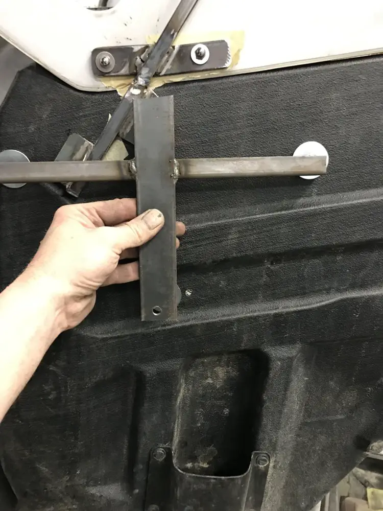

This is the bracket before install to the door. Put j-nuts on backsides for ease of install. You can see the upper right corner goes into the hinge area then I'll foam for strength. 7cac4258ca950f69903d4ab440b9f262

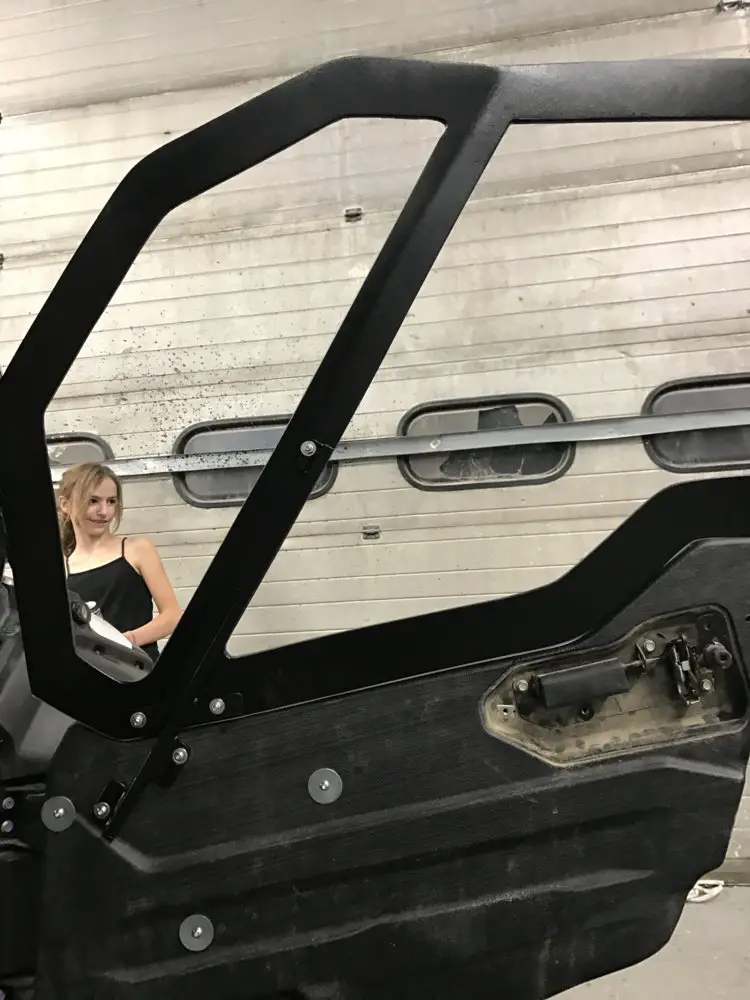

Front mount done both sides. Sprayed everything with bed liner. Very little wobble with only one mount.need to spray all the stainless hardware but close. She's a keeper.

View attachment 26976 Front mount done both sides. Sprayed everything with bed liner. Very little wobble with only one mount.need to spray all the stainless hardware but close. She's a keeper.
WOW! That is solid! What keeps the rear of the window sitting squarely on the dooro_O Is there a pin or shaft from the window frame into the dooro_O
Still have to put rear mount in right now its all on the front. Made me feel good to know that all the effort on the front paid off pretty happy. I'm hoping it'll all stay there's a ton of overkill but till it hits trails and trailing you don't know

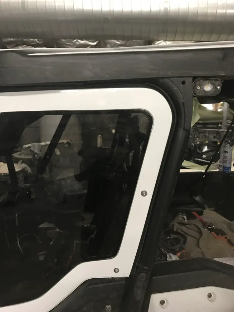

Headed camping so busting ass to get the Pioneer back up and waterproof. Rubber seal I choose works like a champ! IMG 7316
